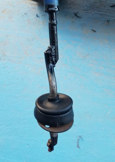

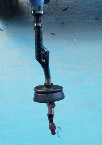

This is the mod I did for the 4WD gear stick after the 2" body lift. This prevents the gear stick from hitting the floor and not fulling engaging into 4WD Low Range. I extended the height and also moved it forward from its original position.
For the 5 Speed gear stick, I cut a small triangular notch on the front of the stick close to the gear box, bent it forward about 1.5 inches and welded it afterwards, so that has also been moved forward.

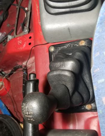

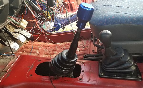

Prior to that, 3rd gear was touching the 4WD gear stick. The pic above shows the gear stick in 3rd gear after I did the mods, about where it is when stock.
