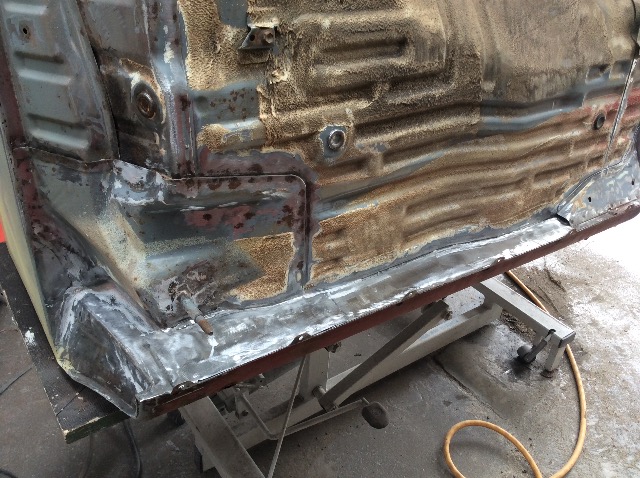

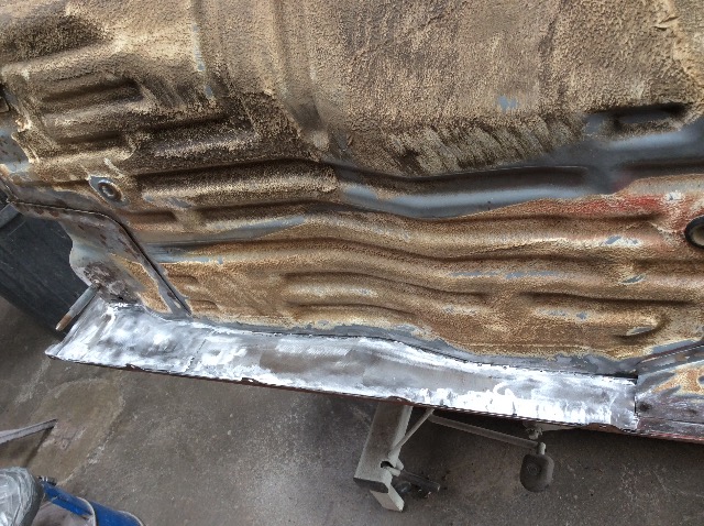

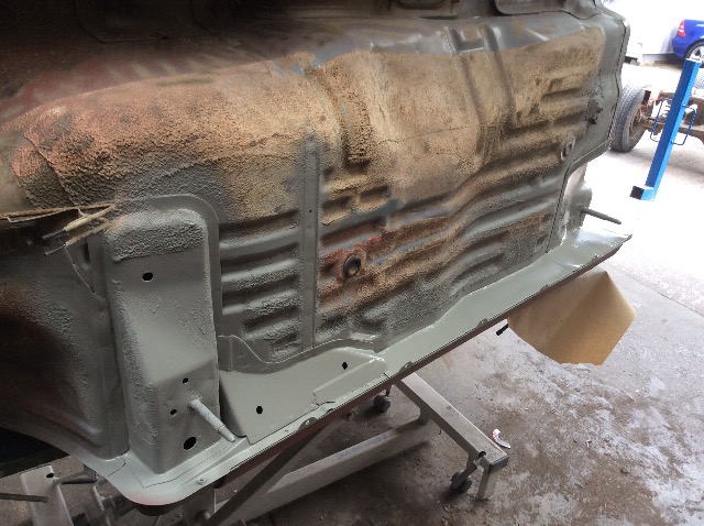

A Productive mornings work on one half of the cab underfloor area, hoping to get the other side done then the whole underside covered in raptor

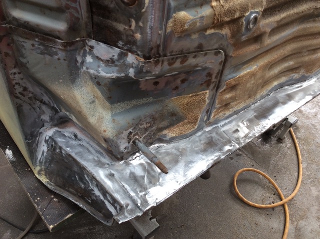

Does the rust need treating or does the raptor do it all at the same time?

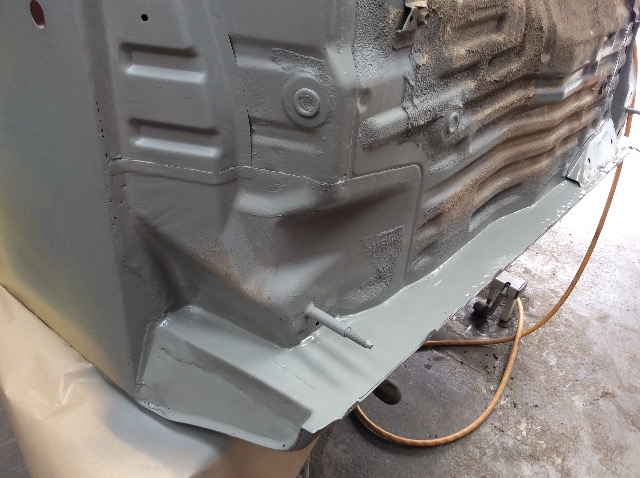

05 Apr 2020 12:00 #220715 by Jimny Dr
Daniel30 wrote: Does the rust need treating or does the raptor do it all at the same time?
there you go all bare metal now covered with etch primer
Then the raptor is applied last

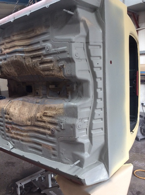

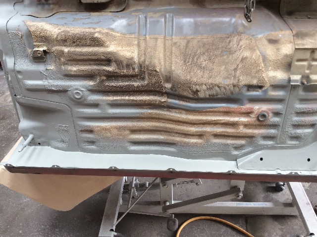

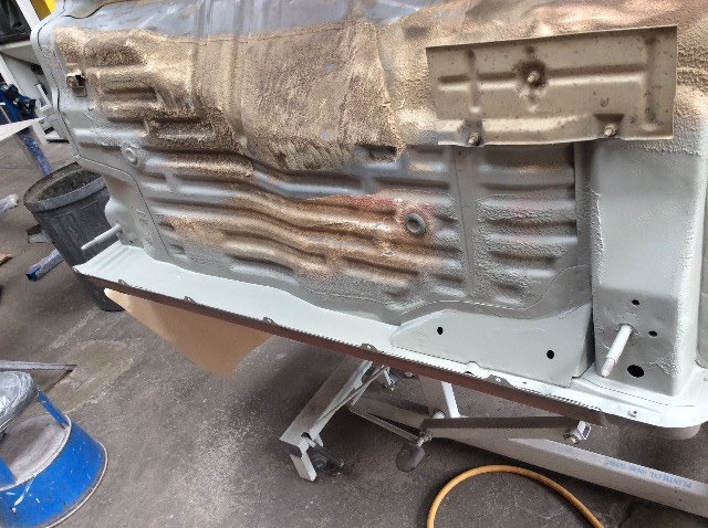

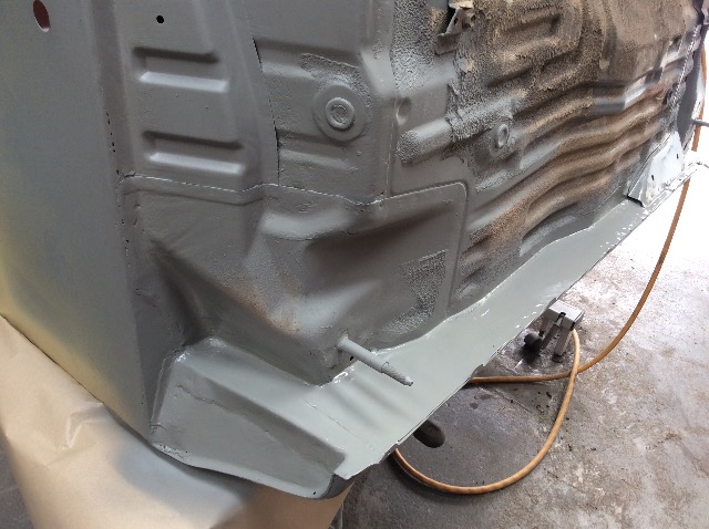

05 Apr 2020 15:52 #220728 by Jimny Dr
all floor pan and under sills now completed ,2 generous coats of etch primer and going to raptor next
