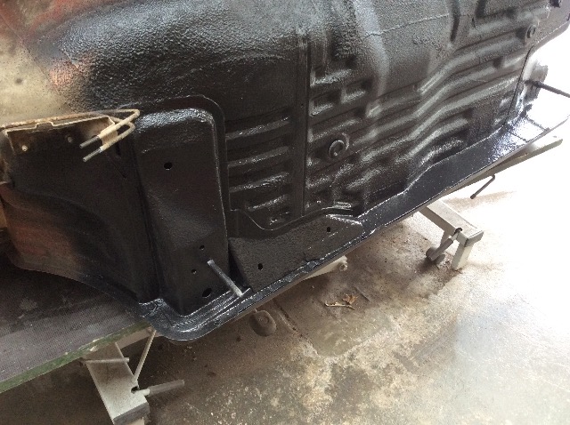

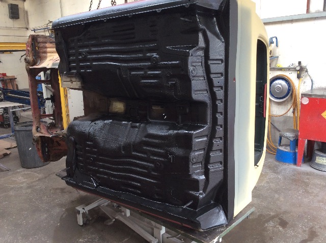

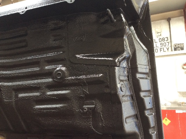

Very nice....

I've just noticed you guys left the vacuum pipes in place. Are you planning to use them? If so it might be worth replacing them with new copper ones?

Yes we tasted all the vacuum system and it worked fine so there ok to go again, but we replace the pipes on the axle with silicone hose regardless
When we do the rebuild

Great stuff Doc....
Are you doing any mechanical work while the cab is off..?

Yes we will be rebuilding the gearbox with bearings and seals, fitting new clutch unit at same time.
Then we will work from front to back of the chassis doing brake pipes radius arm caster correct bushes then the rest in polybush new 2” black raptor lift kit aswell.
This is going to be a nice little work horse for some one when it’s done, you know me sniper it has to be Wright
Our moto is do it Wright do it once
Pictures of today’s progress to follow
