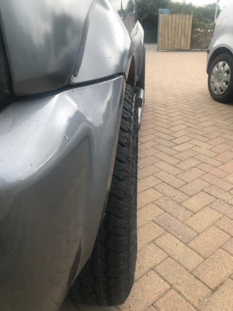

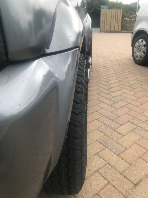

Hi guys,
I did my first long distance drive today, Cornwall to Bristol so was good opportunity to listen to all the noises the Jimny makes at high speeds, at first it was a lot to get used to as no matter what I’m guessing the Jimny is a loud car with wind and road always droning on but that’s fine and I knew that when I was buying.
I did notice 4 things though that I thought I should check with everyone. Firstly at about 65+ mph there is an oscillating drone, even when coasting, I think it’s coming from the front left, it could be an uneven tyre and I don’t think it’s wheel bearings and kingpins as they where done last year. The second thing is a light thudding at 60+ mph also sounds like from the left and it seems to be on bumpy roads, any of the really new even surfaces and it doesn’t happen, thirdly I noticed occasionally and randomly I went into a wobble of death it would stop if I braked down to 35-45 mph and only happened twice in the 6 hour drive. Finally the last thing is something I’ve noticed when pulling away in first, on a cold engine I can hear low droning for a few seconds pretty much when the initial inertia throws you to the back of your seat (as much as a Jimny can do) I’m wondering if this could be the tyres rubbing as they are far too big at the moment.
Thanks for any advice guys.
— UPDATE—
So the thudding noise was actually more of a scraping noise and I realised the wind was what affected it, looks at the inner wheel arch and a screw was missing, turns out it was loose and scraping the tyre.
The oscillating I’m pretty sure is a flat spot in a tyre.
The pulling away in first still happens only when cold.

In this case the the oscillating noise was one of my wheel arch liners just rubbing against my massive tyres :P The thudding was related to that as I cut the arch liners and it stopped. Wobble of death is well...wobble of death no need to explain. The pulling away noise is still happening, I have a feeling its from my transmission and my massive tyres (still need changing) are just messing with the gearing. More posts and updates to come, done a few bits since last posting on here.

So I've done a fair amount since last posting on here. I have removed all my wheels and replaced both front brake setups, Also whilst wheels were off I cleaned up the rust from the rear drums. Also stuck some spacers on there and got new smaller 215/75/15 tyres put on. Trimmed my front bumper and I also got all the seats and carpets out and did some rust repairs. Also removed some chrome bits because im not a fan. Next thing it to get a proper undercoating done and a good full service to change all the oils and have the machine running good.
