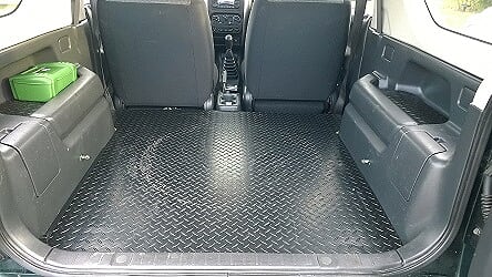

I have also removed the rear seats and have similar to Chris above.
Having made the change I believe that if you have no need for the rear seats take them out, they do nothing but occupy valuable space, even when folded down in the G3.
With them removed you can go for a single load area or a multi layer area, keeping the stay in car bits hidden. Anything is possible and a bit of carpet or covering and it looks professional.

Looks like the back seats are coming out then!
I’m looking to make more of a partitioned container than just a flat loading area but it’s definitely good to see how it looks without the back seats in. Definitely opens it up a fair bit more.
Will have a play once the back seats are out and share some photos of the eventual set up
