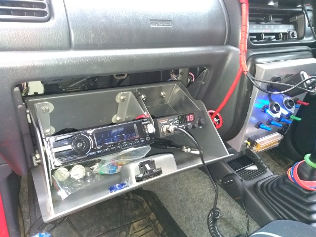

Thank you for the picture about the in-glovebox radio solution. I will consider it.
