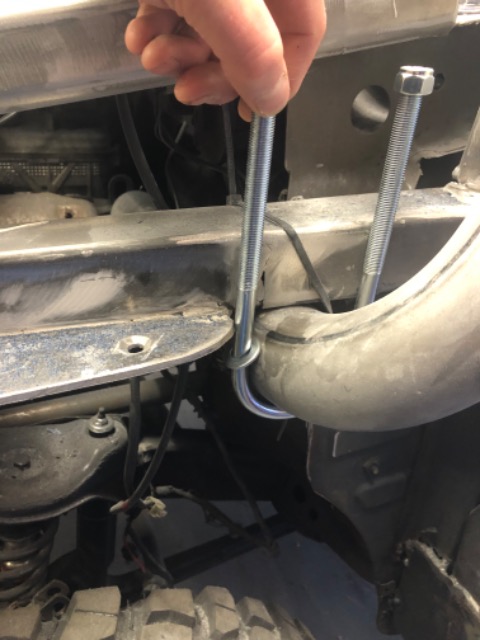

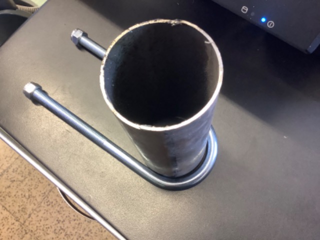

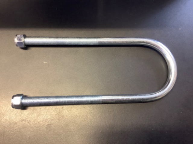

Strange purchase arrived today...
A single Ford Escort lengthened u-bolt for lowering said vehicle...?
Hmmm....
Ahhh...
Took me loads of searching!
It’s the same ID as the outside diameter of a Ford Escort axle tube... obviously!... and my chosen tube size OD for my snorkel!
That’s to clamp it under the 2” box section “bent” wing top
The
Like that... only shortened to length, and when the matching exhaust clamp bit arrives...
Hmmm....
Ahhh...
The

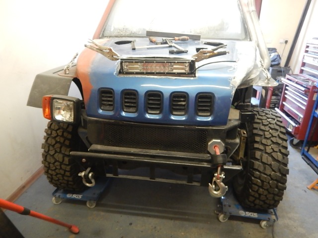

Ok, so Sunday, I had a few hours in-between chores. and have been planning this for a while, so most of the bits are here, and...
Ever wondered whats under the skin of the bonnet at the front? Yup, I wondered too, and had been staring at the underside of it on a few occasions, around the bonnet catch area where it looks flat and boxy...

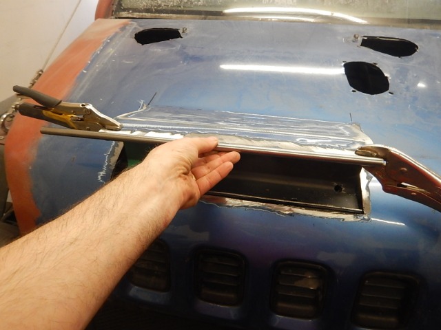

Let's be brave then? measured and marked, double checked, angle grinder armed with a slitting disk in hand... go for it! BZZZzzz....!
Oh blimey!
Top skin cut, but it won't lift up... shoot!
Get a torch and peer in... hmmm, get a wood chisel and try and split what I assumed was spot welds

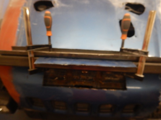

... Hmmm :lol: ... turns out the inner and outer skins are stuck together (in this area anyway) with big rubber dots, about 30mm in diameter, a good few of them, but woody the chisel (told you before all my tools have daft names!) managed to split them all, and I managed to lift the flap with the big 4"x2" box section clamped down to the bonnet skin used to pivot a straight line fold...
(Yup! I make this up as I go along! :laugh: )
Damn, slightly out of focus, but you get the idea... the big piece of box section and a cutoff of half a piece of the same box (that was used to cap the doors, etc...) was clamped together around the outer skin to bend it back the other way...
... to meet some 100mm x 60mm box section that's been cut to fit around an LED light bar...
Some steel bar to make a nice rounded edge to protect the LED light bar from those pesky trees, and the general public just in case...
And I'm waiting for a small strip of 100mm wide steel plate flat bar to cut diagonally to fill the sides, nice and wide 6mm to give me something to weld the thin outer skin of the bonnet to...
The reasoning was, looking at the front of the buggy with it's twin JCB lights to be fitted, they'd probably be worse than the standard Jimny headlights, so some more wattage was needed, and, I couldn't think where to put any spot lights, etc, without getting rid of valuable cooling grills, and sticking on the bonnet edge wasn't an option without some protection from them there pesky trees, and I figured it would "look right" too...
I was going to leave this addition til later, but there's no point me finishing and painting the bonnet to then have to do this later, so I bit the bullet and got the grinder out... :woohoo:
That's better... couldn't help but share that one
