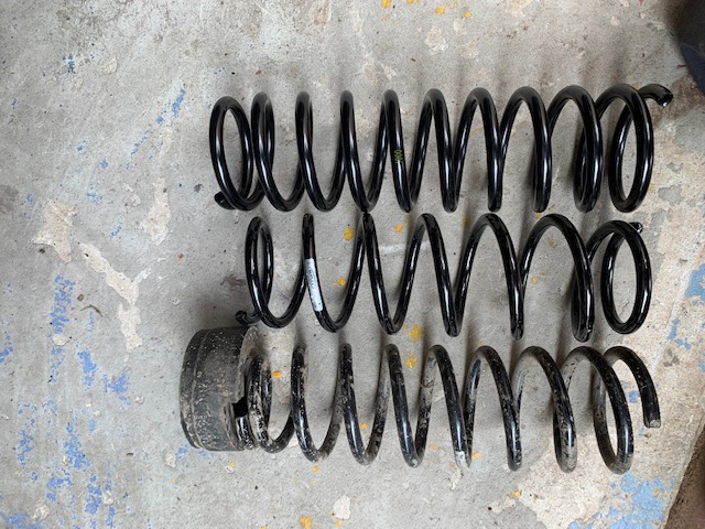

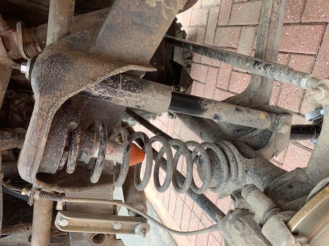

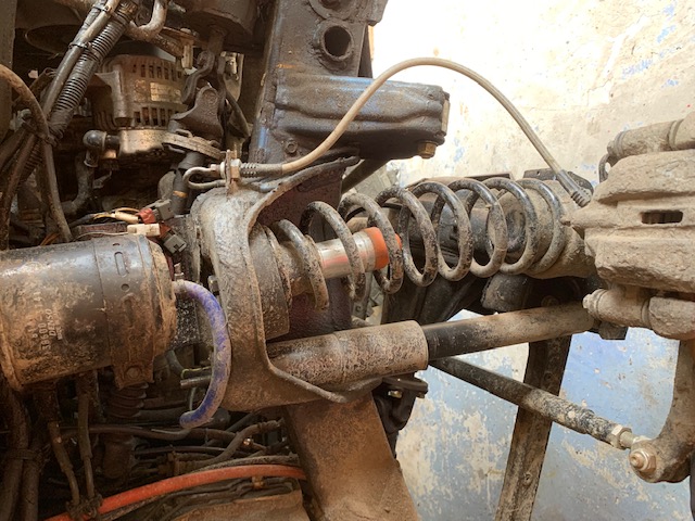

When I was out locally the other day I felt the front springs were too soft, and I felt the bump stops hit the axle prematurely a few times...
Current setup, or previous by the time I've written this :lol: new OE spec Supflex front springs with some of my old spring spacers on the top, and a RW machined bumpstop extension with a polyurethane bump stop... Note the curvature of the spring too, this is partly as I'm currently running SuperPro castor correction bushes but they are set to push the axle forward away from the bulkhead, so the front axle is probably 10mm further forward than it should be...

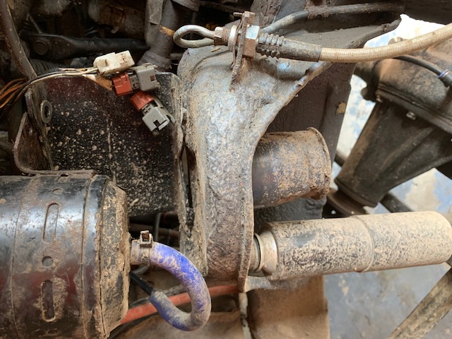

Spring out, and I had to twist the carbon canister out of the way on it's new mount to get the bumpstop spacer out...
Comparison of the springs - on the left the Supflex spring and spacer, in the middle a new Supflex spring (off the lil'bugga parts pile) to check the spring hadn't sagged, and on the right the new +2" JimnyBits lift spring...

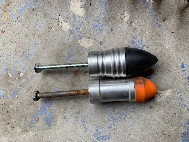

Comparison of the bumpstop / spacers, original one on the left, JimnyBits one on the right... you can see the cone is deeper and made of softer rubber than the quite harsh and somewhat blunt polyurethane cone...

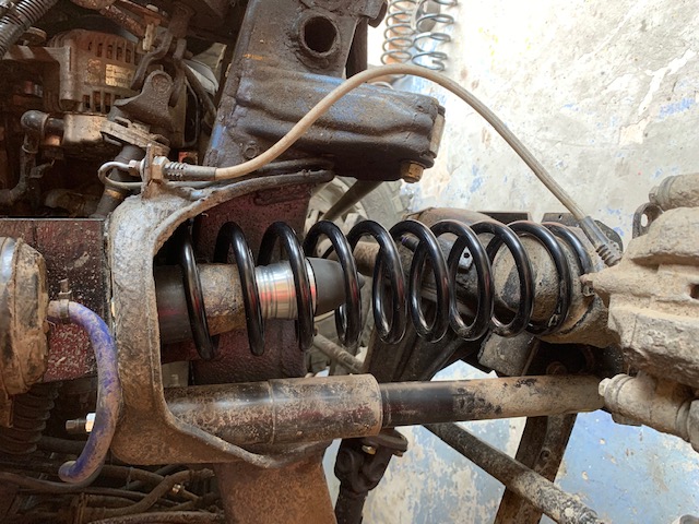

New bump stop spacer and cone installed...
New spring installed, on a new rubber spring seat... that's sitting much better, and is wound from thicker wire so we shouldn't hit the bumps prematurely now, and when we do hit the bump it'll be a softer landing and a lot less harsh

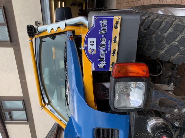

This week my attendance pack for the BigJimny Meet arrived
I'd assumed the "rally badge" was going to be a sticker... but when I opened the pack it was a nice plastic sheet one with two big ty-wraps... but where was I going to attach that on the front of the buggy?
Hmmm...

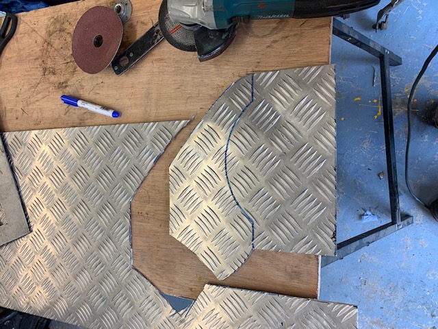

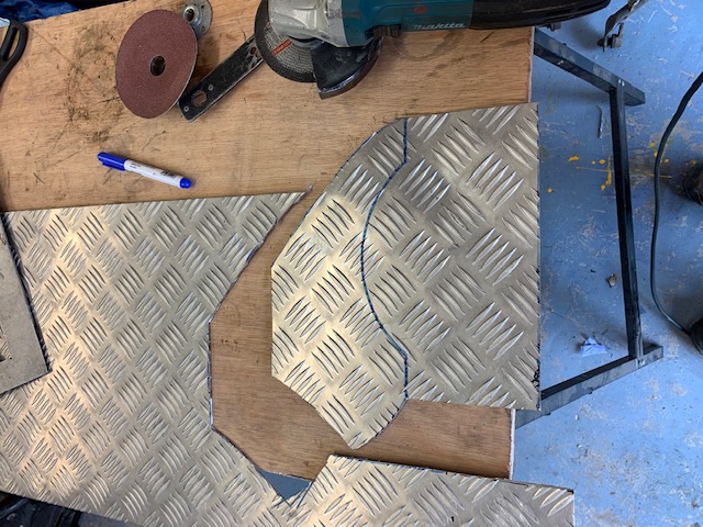

Enter some aluminium chequer plate, and a cardboard template ("CAD" again... Cardboard Aided Design! :lol: )
Now you can see where I'm heading...
"If a job's worth doing, it's worth doing right" !
Aye, that'll do
Aye, that'll do

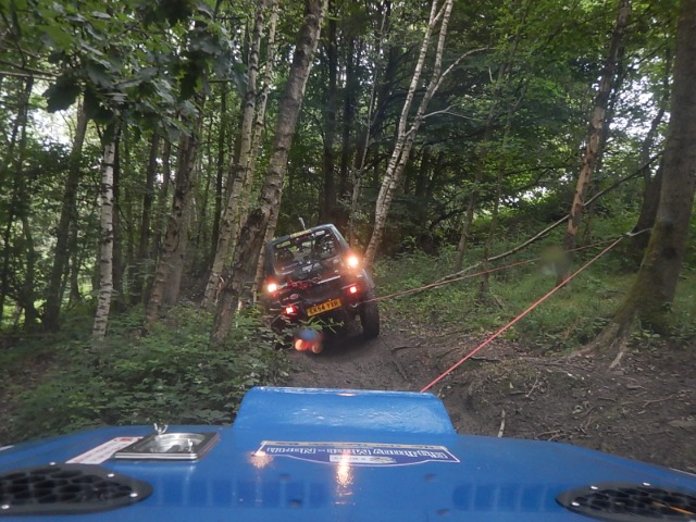

Off we (our little group) go, and my winch is soon called into duty for the first time... Parkwood (Tong) is a multi-use venue, and it seems we've turned down a motorbike track?! VERY narrow through these trees, so I give Brett a little tug backwards...
And we all eventually circumnavigate the offending tree...

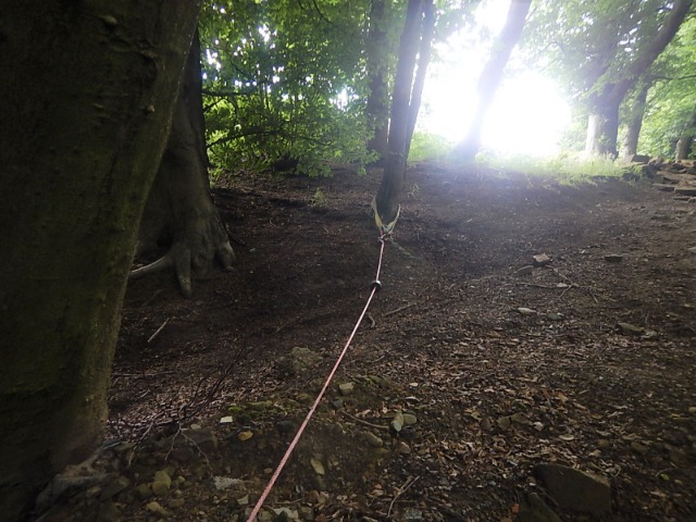

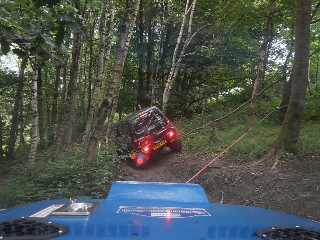

Later in the day... on my own, I strayed onto another bike track... I'm sure there was a red arrow (the routes were marked blue, red, black in order of severity)...
And dropped down a very steep bank and then had no-where to go
so I looked around on foot and decided the only way to go was back the way I had come (down that big bank)...
So a tree was called in to assist as a ground anchor, and I winched / revved my way back up the bank...

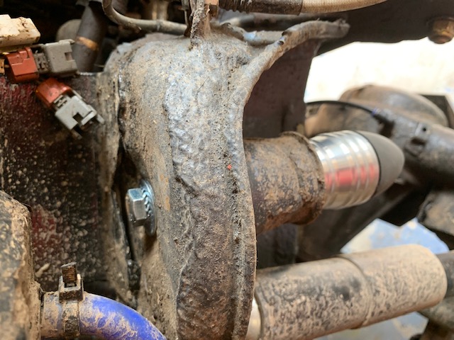

Later in the day I managed to rip some of my front nearside / passenger mudguard off, and thankfully James (Lines, Martin's son) was passing and gave me some ty-wraps to perform an emergency fix... THANKS James!
