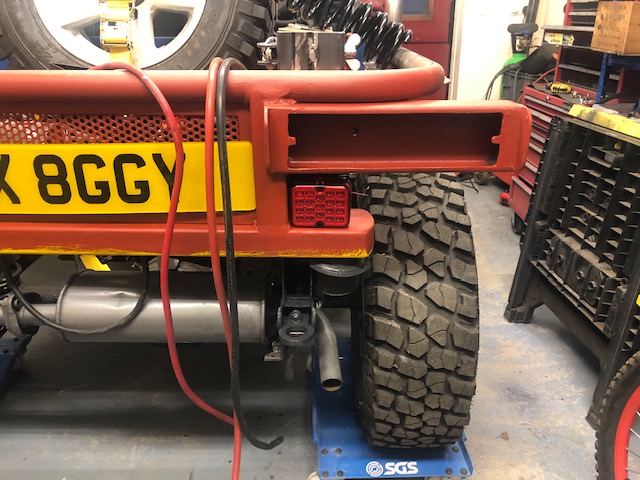

Bugger... stood at my till thinking about the buggy... what’s missing from the rear?
A blummin’ foglight ?!
Bah...
I’ll have to add one just below the offside rear light cluster?...
They’re SJ / Samurai rear lights and don’t feature fog lights
Bah...

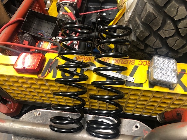

The 2" rear lift springs from JimnyBits turned up this morning, next day delivery... impressive!
And I found a pair of LED fog lights and reverse lights from a previous project (the fastback Jimny) in the garage...
So the fog light is an easy fix, just a bracket here'ish...

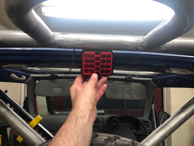

And I figured the other one would make a good...
... a good centre hi-level brake light up here at the back of the small winch rope loop, on the back of the halo-hoop..
I decided not to use the reverse lights, as either reverse lights or work lights over the winch area, as I don't plan on greenlaning in the dark...

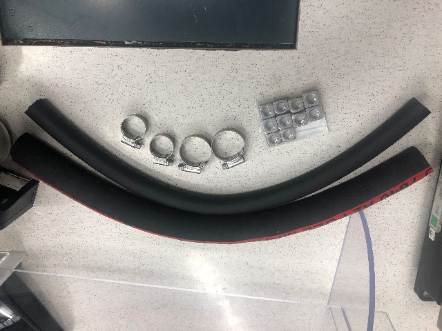

New fuel filler and return hoses, old ones were a little too short and very old and floppy :lol:
Matching new jubilee clips
Square nuts for the winch mounts... had the right length bolts “in stock” but can I find the original square nuts that came with the winch?! :laugh:

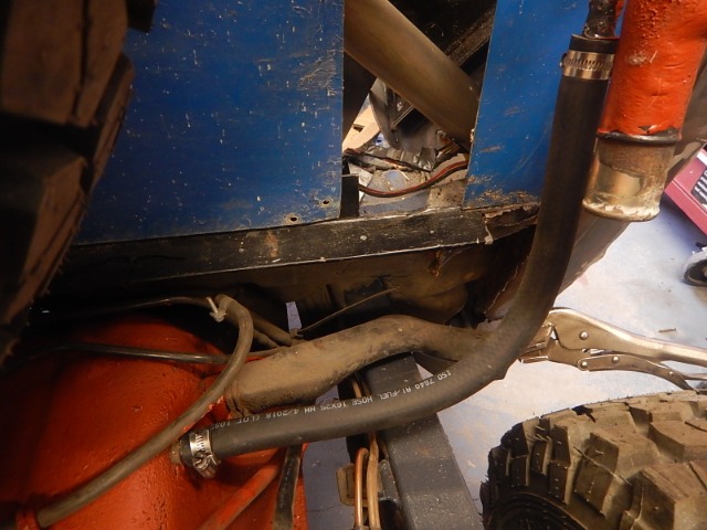

I started early, and hence quietly. by fitting the fuel tank hose(s)... errr, just the return one then? As I'd mis-measured / ordered the filler hose.. so another one is on the way... :lol:

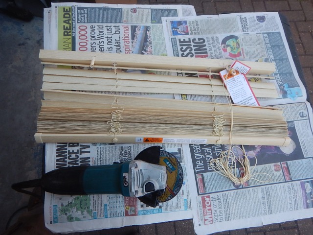

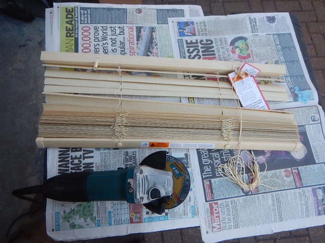

And then the missus grabbed me and wanted two blinds trimming to size and hanging, a mirror screwing to the wall, and a hidden-mount shelf putting up... :lol: They've been re-decorating the daughters bedrooms, so I couldn't really say No? :ohmy:
So, when I eventually got back to the garage...

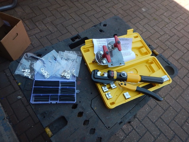

I thought I'd have a play with the new [strike]toy[/strike]... errr, tool...

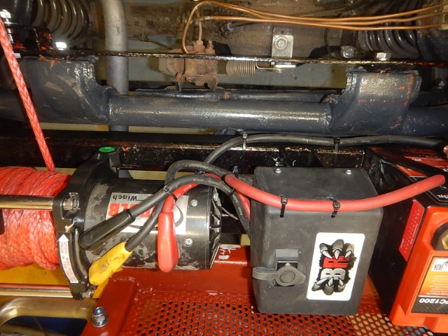

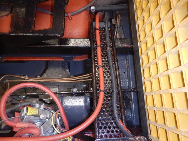

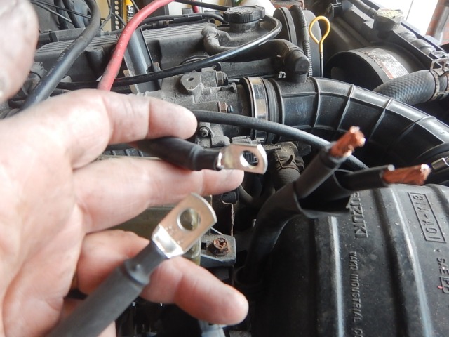

So I bolted down the winch solenoid pack to it's mount, and then tidied all the cables, shortening the positive and negative battery cables, ready to connect to the switch(es)...

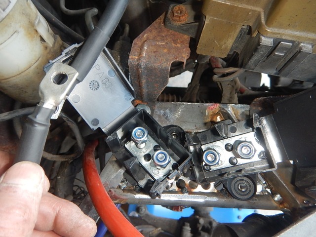

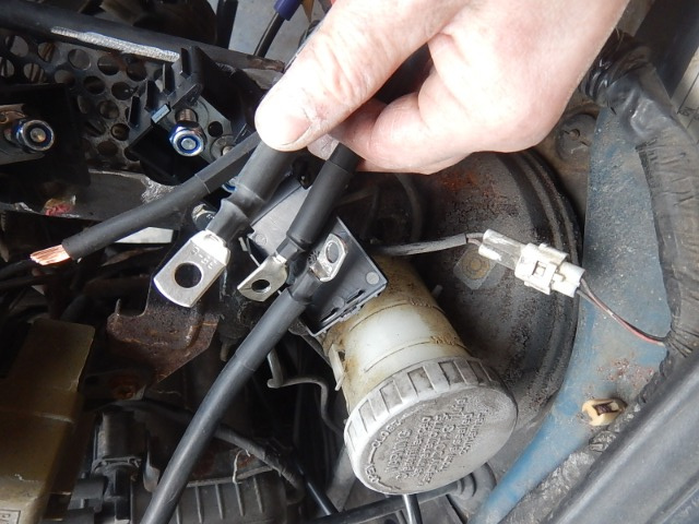

Unfortunately, at the front, I've misjudged the size of the standard battery cables, so I've ordered some more crimp connectors hopefully ready for Wednesday... But these are the negative cables, so one to the back winch battery, one to the vehicle's chassis ground, one to the original engine bay wiring (currently bare need a 16mm2 crimp for that) and one over to the engine battery, eventually, when it gets a cradle mount on the passenger side...
And these are the positive cables, so one to the back winch battery (switch), one over to the engine battery, and another two bare 16mm2 original engine bay wires that I also need crimp terminals for..
They'll all connect up in these two connector terminal boxes... soon... I'll paint the bracketry this week before Wednesday, and hopefully the new crimp terminals will also appear in the post on Wednesday...? Get them all bolted in, and hopefully test-fire the engine... it hasn't run for a good while! :ohmy: !

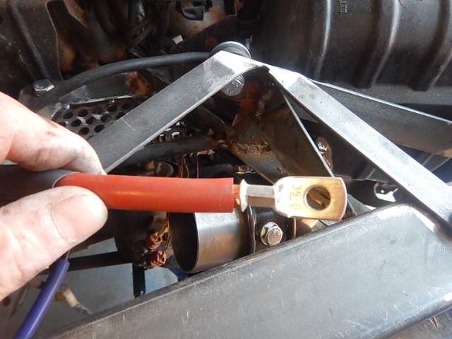

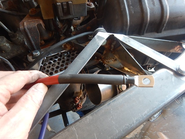

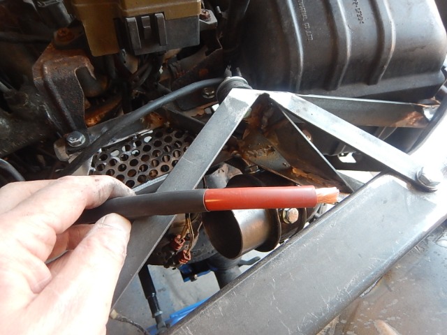

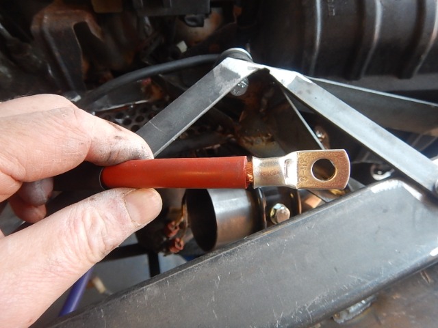

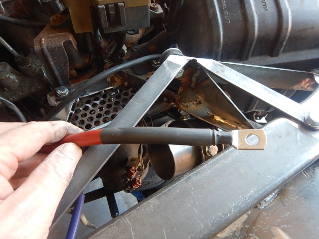

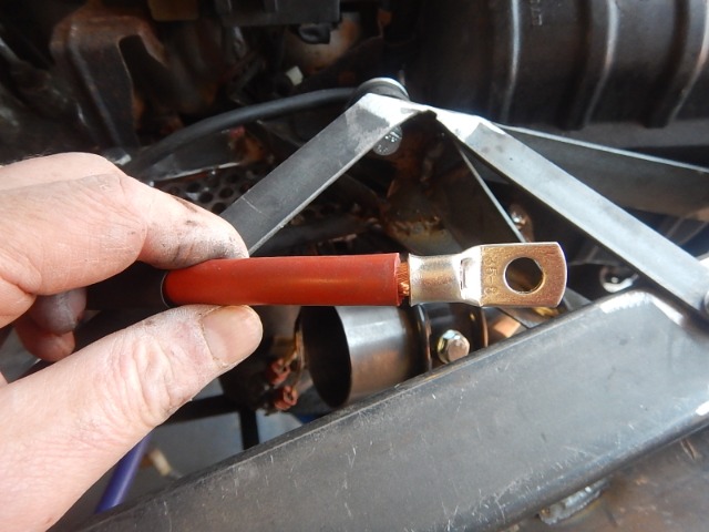

Here's the cable crimp tool in action if it helps anyone?...
Heat shrink sleeve placed over the cable and then aprrox 12mm of cable sheath removed...
Crimp terminal slipped over the exposed copper cable...

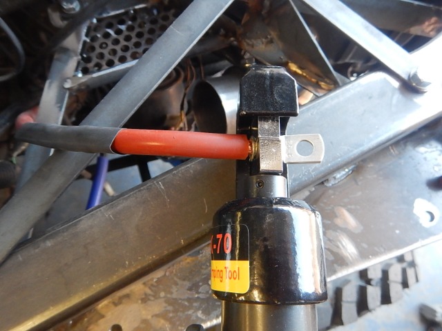

Crimp tool used to make the...
... crimp
and then...
Hot air gun used to heat the heat-shrink sleave...
Et'Voila!
