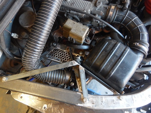

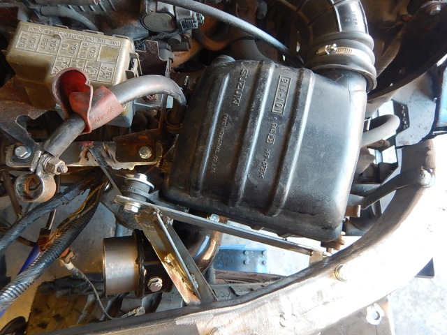

I started "quite quiet" Wednesday by cutting a 3" (75mm?) piece off the end off the snorkel steel 2.5" tube and sanded it nice, and then inserted that into the elbow in the airbox I fitted last week, and then mastic'ed and bolted it in place again...
I then added some more triangulation and some perforated steel plate, this will house the battery lead connectors - must order them! :ohmy:
The battery link cables are here though, so I laid them along the chassis rails front to back and ty-wrapped them in place...

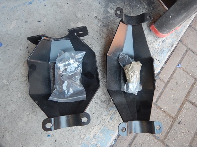

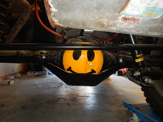

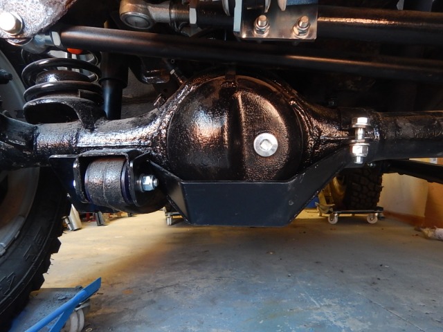

Whilst lying under the buggy doing the cables, I remembered I hadn't fitted these yet... I've had them a while but not got round to them, but that's another "quite quiet job" ;)
Front on, bit fiddly to get the radius arm bolts through, but nice fit...
And the rear... good job there's no oil in the "lunchbox" and TG HD shafts equipped rear axle yet! ;)
Some debate on these on the forum lately, but these came up at a good price via James Priestly, who often sells JimnyBits parts, so I snapped them up, so almost a full set of JB guards now... front and rear shock guards and radius arm mount guards, fuel tank guard, repeater guards yet to be fitted, and now diff guards too... The buggy is running 30" tyres with just a bit (~1.5") of a suspension lift, so guards, lunchbox in the rear and pick my line well when following the bigger Jimnys in the group... lightness and that should get me through, if not the winch comes out to play :lol:

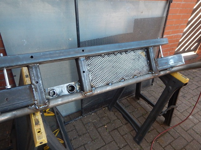

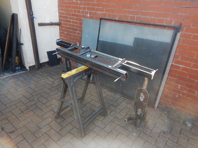

I then finished up tacking all the rear together and then heaved it out into the sunshine to weld it all up...
Not bad considering my failing eyesight! :lol: LOL
And all ready for a nice noisy Sunday with the grinder tidying it all up B)
