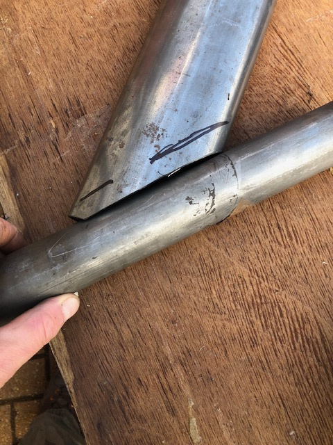

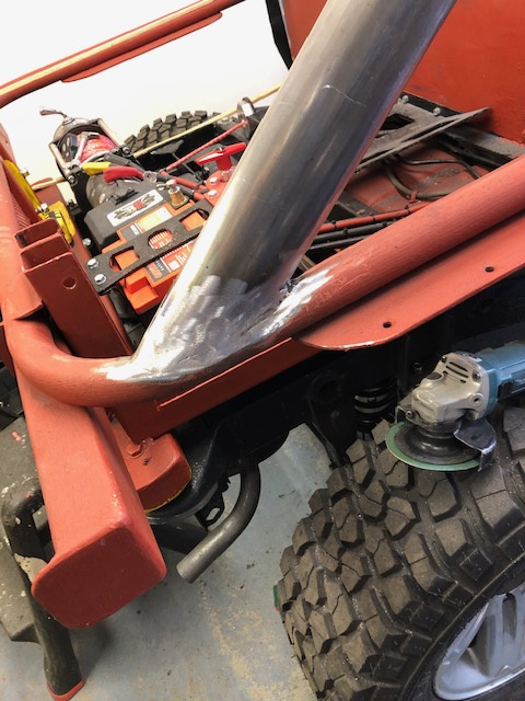

So the first job was to try and work out how the hell to shape the end of the elliptical tube to sit on a round tube, i.e. the back loop of the buggy 'tub' -
Playing on the bench with the marked end of the elliptical tube and an offcut of the seamless tube the same size as the rear tub loop...
Committed, I went for it!...

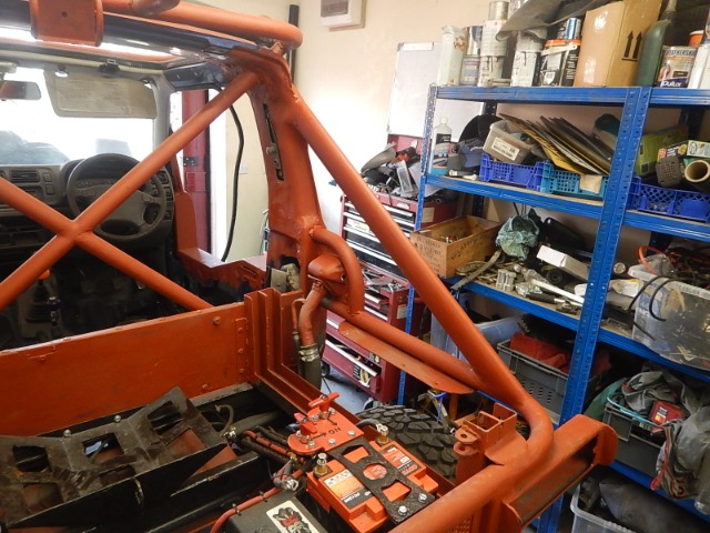

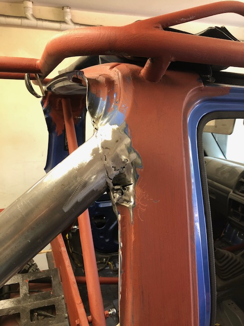

The top where the elliptical rube slotted into the original soft-top body diagonal, the idea being to replicate and extend the angle / line of it...
IN! quite happy with that, plenty of grinding and sanding and just a minimal touch of body filler to finish it to...

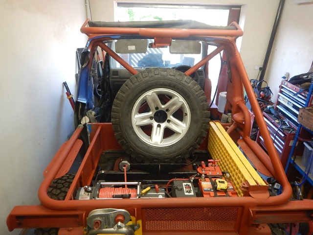

The diagonal in place...
And from the other side...

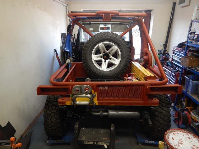

Final photo of the day, happy with that, good progress, but now home and showered and about to join the rest of the family for a "fakeaway" KFC treat for Father's Day...

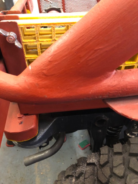

Looking back at the photos last night, they didn’t show the joins in the elliptical diagonal very well, so here’s some closeups...
That needs a little bit of filler to finish it off...

That's looking very neat so is that somehow tied into the rear cross bars or the roof halo?
