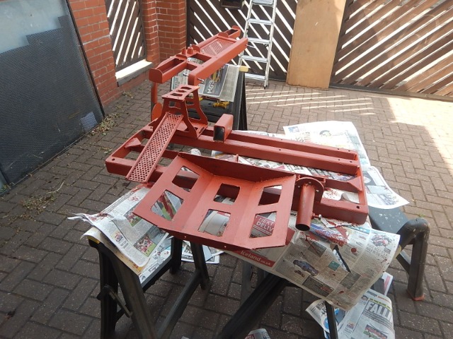

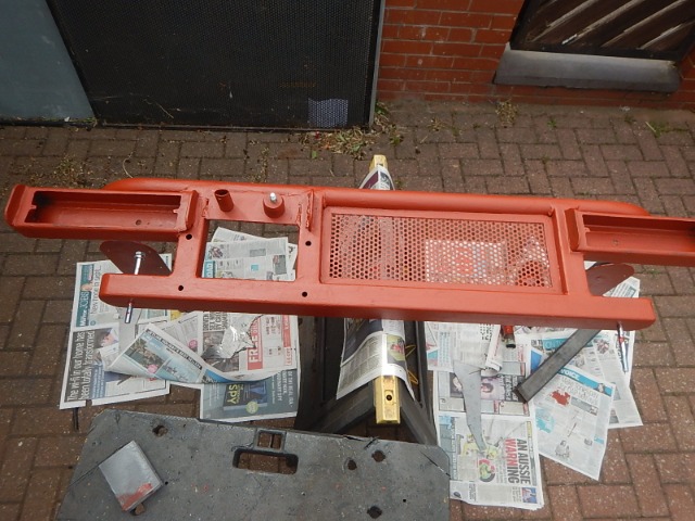

All ground and sanded back, and out came the Red-Oxide paint...

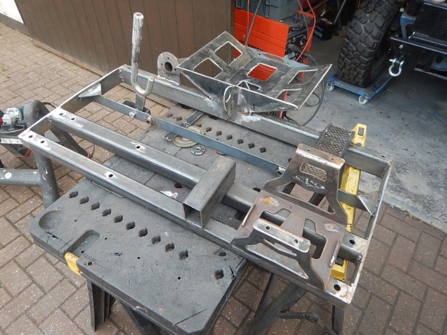

I then made some bits for the rear chassis tray while the paint dried, and then turned it over and did the otherside...
I then welded the new bits to the chassis tray - the winch rope guide handle, some triangulation, the end of the winch rope tube with the fairlead mount on the end, and a small guide for the battery cables...

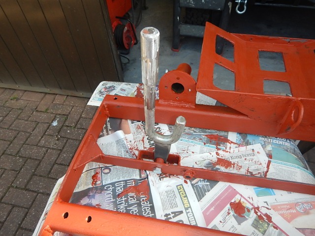

You can see that better in this photo as it's been turned round for painting...

The winch rope guide handle... that will be passed to my mate Rich who runs FloFlex Polyurethane to go in their next batch of zinc plating (as the U in the guide will have the rope rubbing against it, paint would wear off)... and then a bicycle handlebar rubber grip will go on the wider diameter bit at the top
