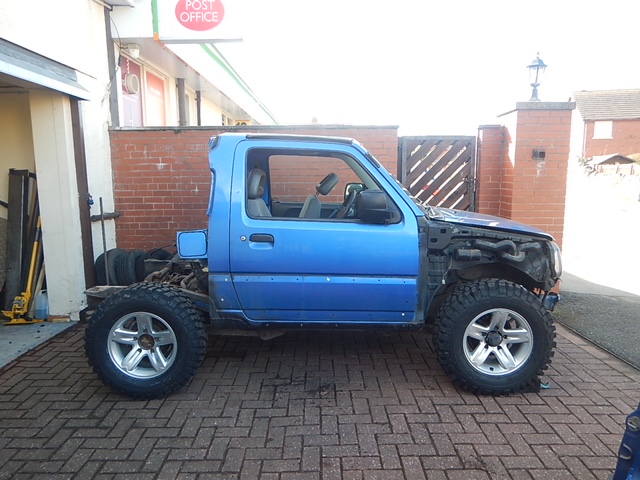

I then set about stripping it -
And in the meantime had a trip to Leeds to pick up a set of five Grand Vitara 16" alloys and had them shod with 235/70/16 Malatesta Camel tyres...

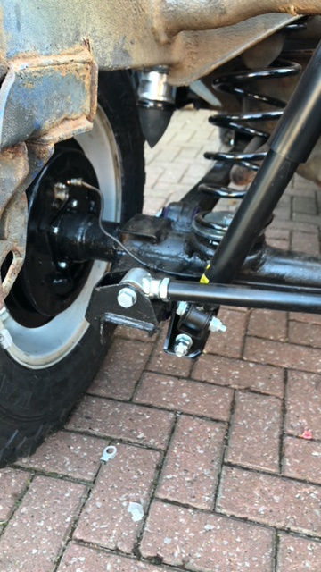

I then started on the rear suspension and transmission -
Rear lift done. The suspension lift is basic, I bought new front springs to go front and back with the fronts having a pair of my 1.5" spring spacers on top, just enough lift with the bigger tyres without getting into steering wobble / vagueness territory - KISS - Keep it Simple Stupid!
Rebuilt axle with a Lunchbox locker built into a VVT diff to correct the gearing for the bigger tyres, TrailGear shafts, new bearings, seals, SuperPro bushes. Monroe Adventure shocks with spacers / repositioners and shock guards, panhard rod, bump stop spacers and cones (most of these parts came from JimnyBits) and spring clamps holding the new front springs in place...

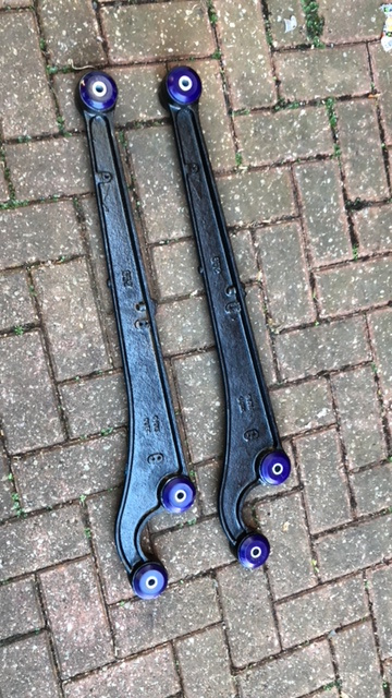

Radius Arms cleaned up, couple of coats of hammerite and then SuperPro bushes pulled in.
Even fitted my own bearings and collars this time with some seamless tube and a lump hammer.

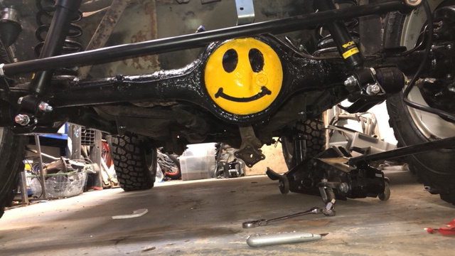

And with the axle being repainted, it had to have a nice smiley face which will be visible from behind!
The Lunchbox Locker (same as a Lockright only cheaper) going in.

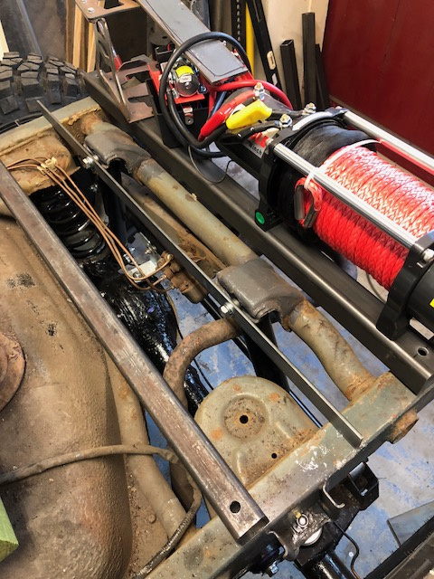

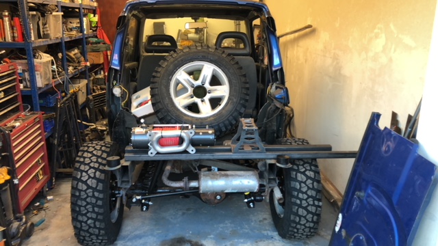

Lately I've been making a mount for the rear winch and battery -
A Black Raptor winch, again sourced from jimnyBits, with an Odyssey PC1200 battery cradle I had in the garage, mounted right at the back of the chassis for weight distribution, and so that it can be used to winch forwards and backwards - the rop will run forward through a couple of donut fairleads at either end of a seamless tube that goes under the passengers (Alan's!) seat and down the side of the engine, and to winch backwards you take a loop off the drum through a huge fairlead and use a snatch block in the loop of rope.
The mounting tray bolts through the chassis (no chassis mods! Been there, done that!) -

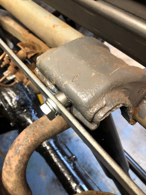

And due to the damage to both shock mounts on my S200KYS Jimny I also braced the shock mounts by fitting long bolts running through a 5mm steel bar brace.
From the back you can see the big fairlead (off a Warn 8274), the lovely tread pattern on the tyres, and the removed back.

Speaking of funds... money is tight at the moment, particularly with Bits4Vits and ZookBOB being shut for January while I was ill, but I have already amassed a load of parts, so I figure my progress will be with what I've got already, so -
Finish the rear winch mount first.
For the front axle / suspension I have a pair of new front springs with spring spacers on the top, Monroe Adventure Grand Vitara (rear) shocks, shock guards, a new panhard rod, SuperPro bushes to go in the radius arms, a VVT diff and the rear diff that came out of the back to convert it into 26 splines to take some front TrailGear shafts that I've yet to save up for... And it'll need new bearings and seals for the rebuild of the transmission, so I'd better start scrimping for a bit!

The winch is a clever idea, also keen to see how it routes through to the front. What are these 'donuts' you speak of? Like a pillow block bearing, but for rope?
