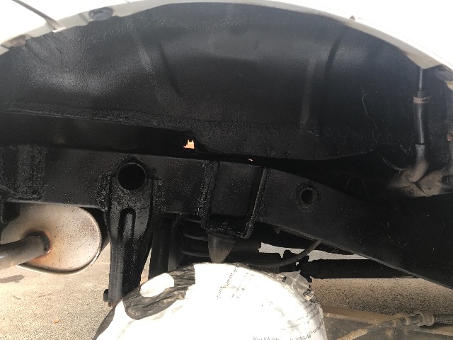

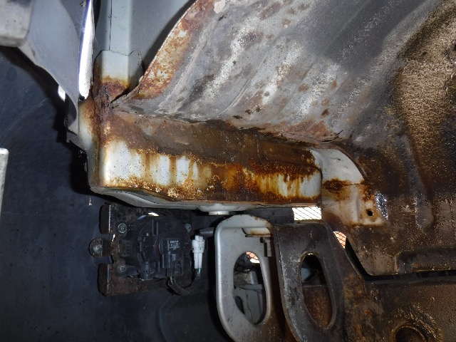

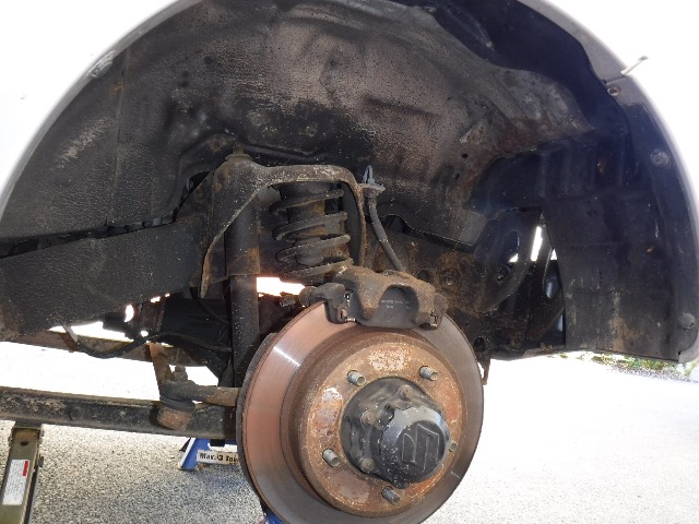

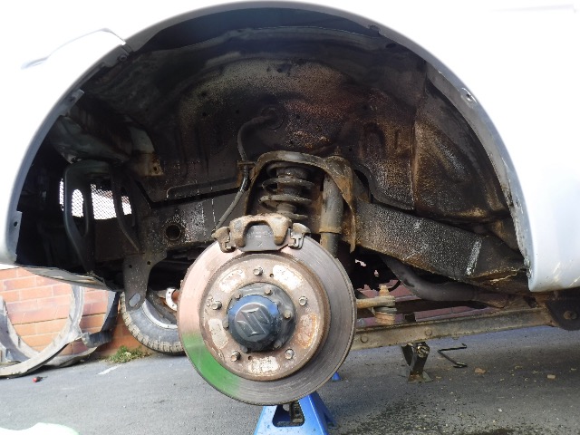

I’ll steer clear of the wheel spacers for now, and Im still struggling to stop the exhaust knock. It’s the silencer knocking near its mount.

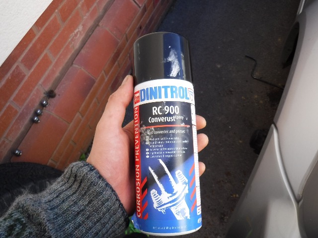

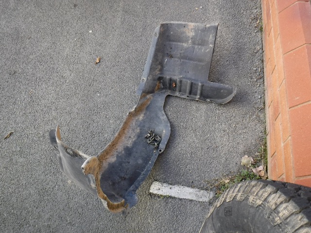

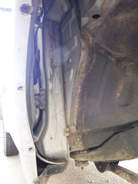

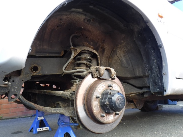

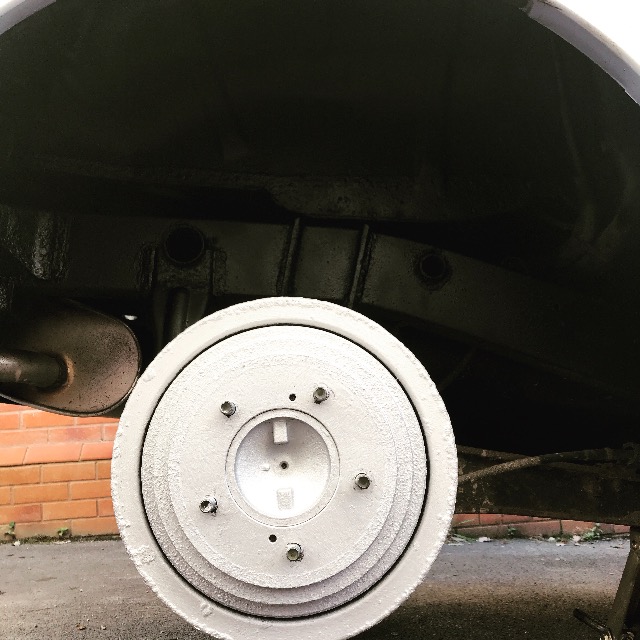

Started rust proofing, it was still on factory underseal so I could see every little demon, I’ve cleaned, stripped back, dinitrol rust converter on some then waxoyl underseal for the rear arches so far, front arches tomorrow then underneath.
Thanks for all the knowledge as usual!
