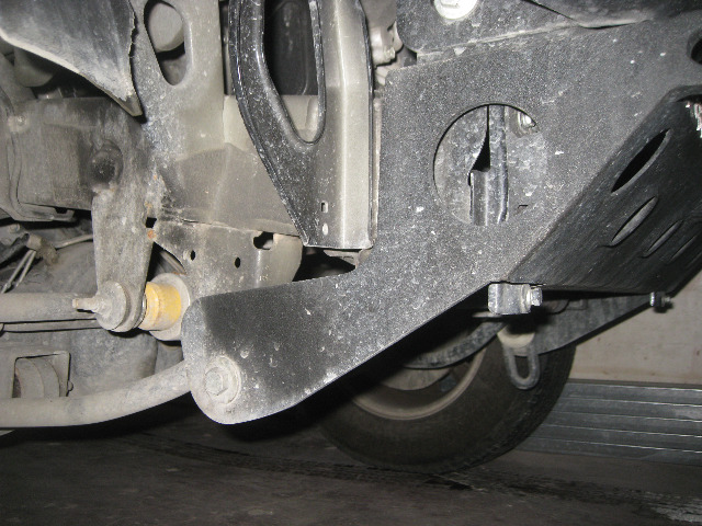

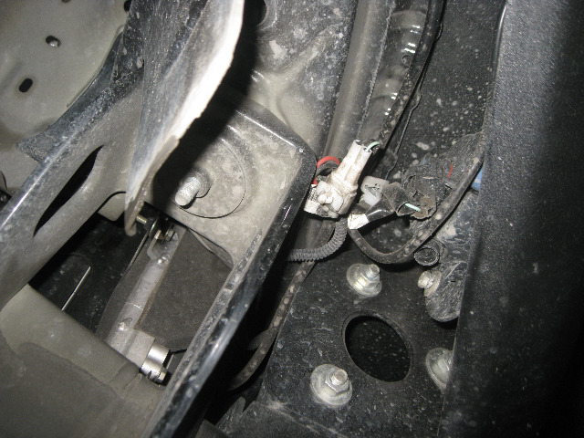

12 Jun 2018 01:46 - 12 Jun 2018 03:21 #193384
by zukebob
Replied by zukebob on topic Alibaba Front Bumper
Water is receding.
Going Down
Should be able to back the Jimny out a little to get some pictures of the mounting today. Hopefully you have been able to research what Kirkynut mentioned.
Update:
These looked good as I was taking them but not sure they show much after actually looking at the pictures.
Let me know if they make any sense.
Lower mounting:
Looking under the bumper:
Going Down
Update:
Lower mounting:

12 Jun 2018 11:34 #193396
by mdog18
Replied by mdog18 on topic Alibaba Front Bumper
Thanks so much for taking the time to post the photos. I was aware of the law kirkynut mentioned, however, as my jim is an 07 reg if there was to be any issues I would probably just say I bought it with the bumper already attached.
I'm still not completely clear as to where the lower mount attaches - I assume it's to some part of the chassis? Also was there any drilling required to attach either the lower mounting or the bumper itself? Also - does the front bumper attach to any part of the car or is it solely attached by the lower mounting?
Thanks again for all your help!
