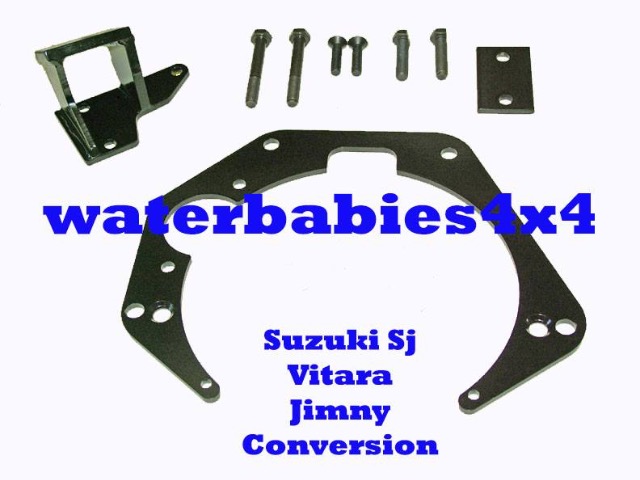

The best engine grand Vitara 2000 -2002 they have the correct cam 11 point cam pick up..waterbabies 4x4 on Facebook and ebay sell the adapter kit..
swap the heater pipe input /output and replace it with the blanking plate in the kit.
Swap the alternator bracket use the jimny one and the jimny power steering pump bracket and use the jimny flywheel and clutch ..use the jimny inlet and exhaust manifolds..you will need a skinny starter motor I found the old vitar as have them on
