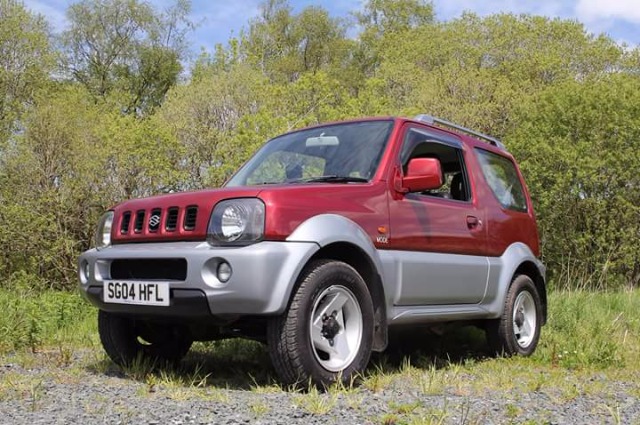

Here she is "new" in 2015. Jimny Mode 2004 with 48,000 miles, but in pretty good condition.

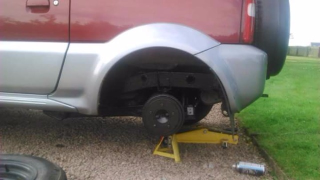

The first modifications were front and rear Jimnybits recovery points after bending the tie-down points during a recovery! Unfortunately I'd slightly bent one of the front chassis rails in an accident getting used to driving the Jimny and how it corners in the wet, so I could only get one of the front recovery points on. I also got steel wheels but with such limited knowledge I ordered 7.5" wide wheels which look cool, but I'm suffering the consequences now with tyre rubbing. I then attempted to rustproof with a wirebrush and hammerite and got a set of stock size Goodyear Wrangler ATs (now for sale).

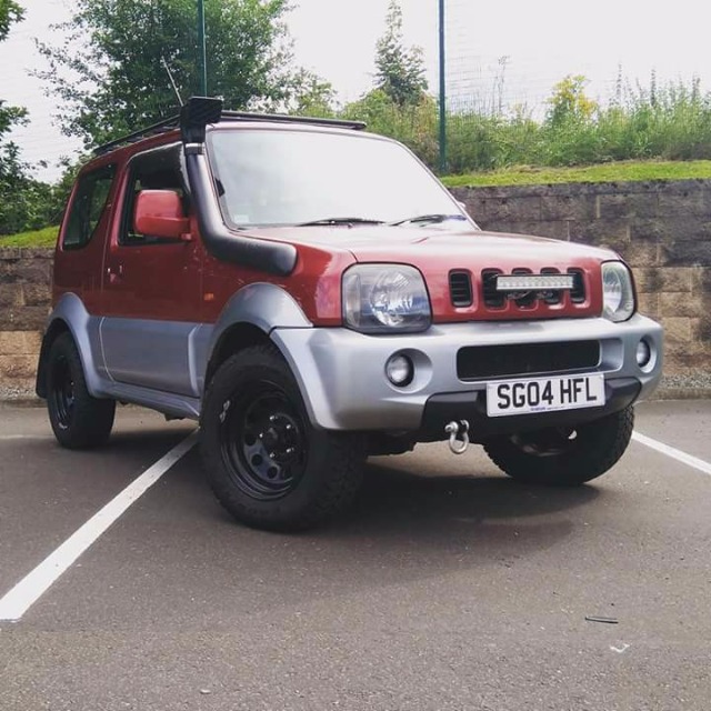

Then came another round of modifications: Jimnybits snorkel, Suntop roofrack and a Jimnybits lightbar mounted on the front of the bonnet. I did all the work myself which was a great learning opportunity! Especially the wiring.

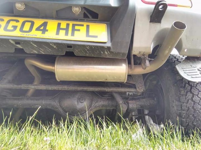

Over the following year I didn't do much, but engaging 4x4 became less and less reliable so I made the jump to AVM manual hubs which have been great. Then my exhaust snapped through and after looking into it I made the decision to get a full length stainless one made, which I'm very happy with! It wasn't the cheapest option, but it was half the price a genuine Suzuki one costs!

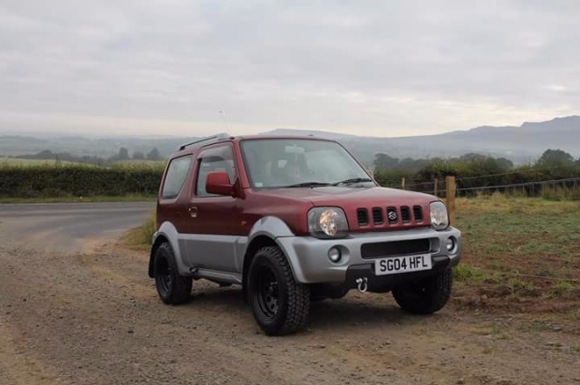

And now the latest modifications. The roofrack was making a lot of wind noise even just at 30mph so I took it to a welder nearby who sorted an air dam at the front. It's now very quiet up to about 60mph. I also removed the lightbar at this point because it was looking quite tatty. The glass had badly fogged up and the paint had all chipped off. It still worked well, but I wasn't using it at all.
I then finally pulled the trigger on a trailmaster 2" comfort lift, and I'm so happy with it. While it was being done I also got a set of ORA radius arm guards fitted that I'd bought ages ago. This was the first modification that I got done at a garage and I'm glad I did because the bolts were all seized, but they put the front springs in the back so I redid the springs myself. I replaced the stock size Wranglers with 215/75/15 General Grabber AT3s which have transformed the look, but unfortunately sometimes rub on the arches.
