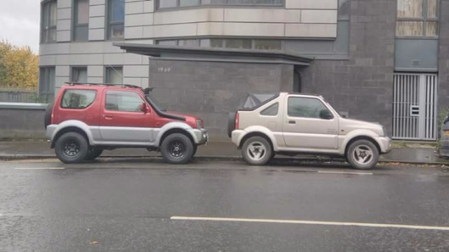

I've been slowly working on my Jimny over the past 2 years and learnt a huge amount from this great forum. I thought it was time I made a record of my Jim's progress so far and of the progress yet to come!
Here she is "new" in 2015. Jimny Mode 2004 with 48,000 miles, but in pretty good condition.

And now the latest modifications. The roofrack was making a lot of wind noise even just at 30mph so I took it to a welder nearby who sorted an air dam at the front. It's now very quiet up to about 60mph. I also removed the lightbar at this point because it was looking quite tatty. The glass had badly fogged up and the paint had all chipped off. It still worked well, but I wasn't using it at all.
I then finally pulled the trigger on a trailmaster 2" comfort lift, and I'm so happy with it. While it was being done I also got a set of ORA radius arm guards fitted that I'd bought ages ago. This was the first modification that I got done at a garage and I'm glad I did because the bolts were all seized, but they put the front springs in the back so I redid the springs myself. I replaced the stock size Wranglers with 215/75/15 General Grabber AT3s which have transformed the look, but unfortunately sometimes rub on the arches.
