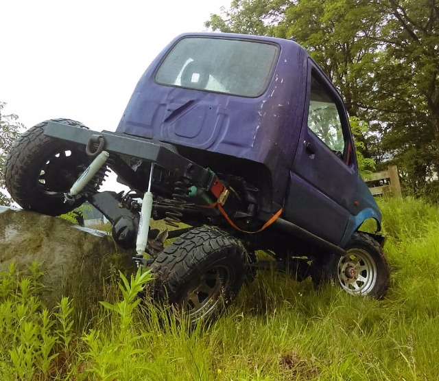

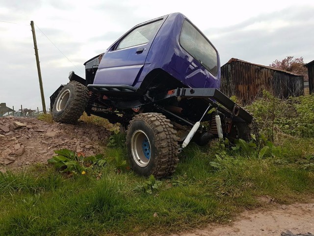

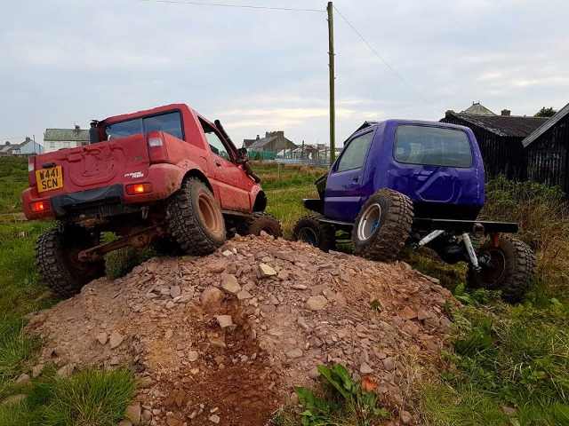

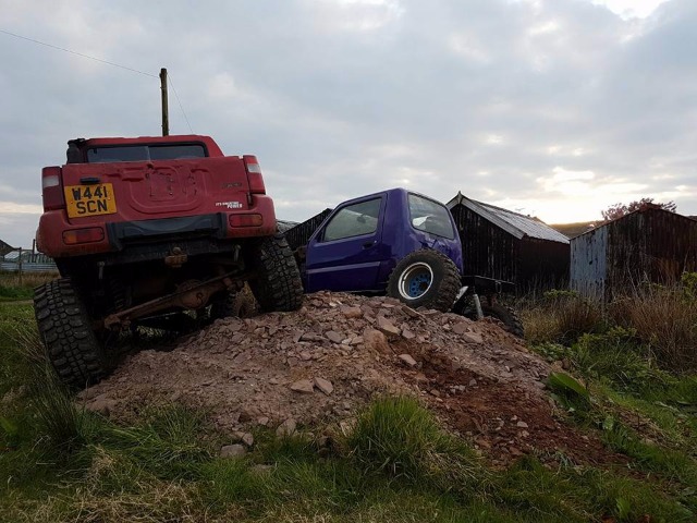

so have managed to have a little test out the backs still no brakes finished yet . also now know the front springs are far to hard so will need something softer as they have no give atoll . also only had rear wheel drive as only had one half shaft in but now has both in so all good . but starting to get there now

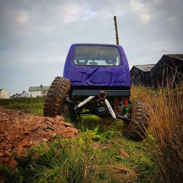

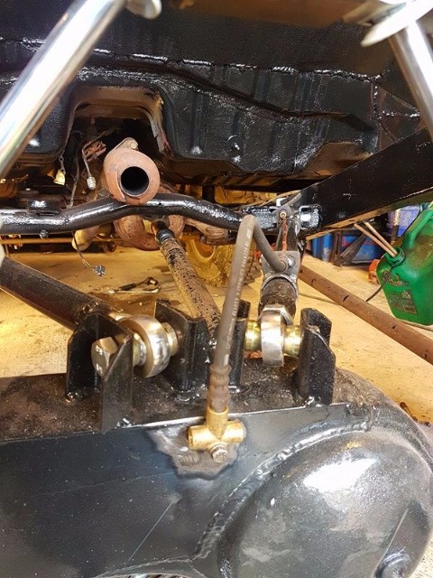

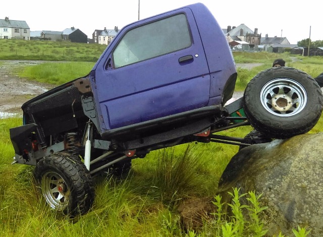

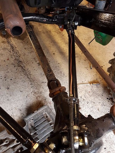

Thanks. And yeah so far. Need some softer springs still I'm the front to allow it to flex more also have some. Bump stops to fit and other odd bits but it's taking shape. Weather it stays 4link front yet I don't know as it's becoming a night mare with exhaust and links prop ect to have any room what so ever for sump and iv made a shallow sump time shall tell
