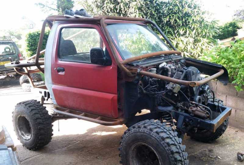

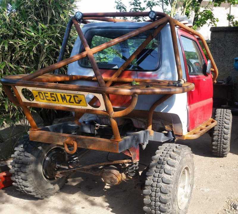

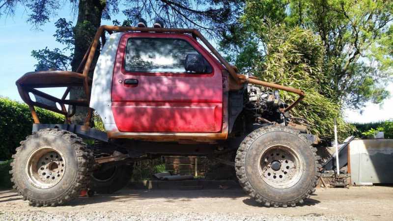

My build so far.. Tray back. Vw tdi motor with land rover fuel pump. Land rover axles. 4 link suspension fully caged some photos from. Before cab removed and axles fitted and links

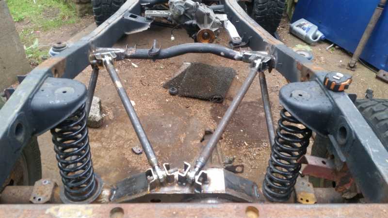

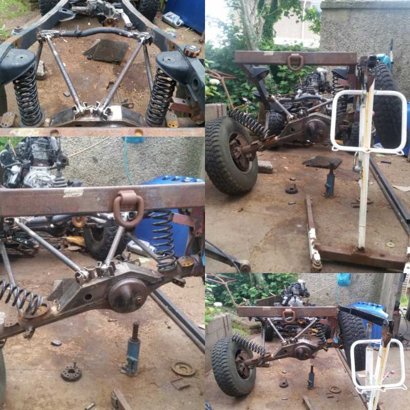

13 Jul 2016 00:03 #169964 by whittleos
Replied by whittleos on topic My tray back tdi 4 link Jimny build
To be honest it's all swings and round abouts I am on with doing front axle now have lower arms in but got tops to do had to cut gear box cross brace out and move forward 4 inch allows links to clear prop shaft and weld flat plate from that back to re mount gear box 4mm wall box I have been using I was going to do the back but no reason to solid only rust on is from me cleaning to weld will all get cleaned back bare then painted etc ..went 4 link as nothing stopping travel no Pan hard rod to limit you etc etc shall jack up again once front finished see what travel I have post pics soon
