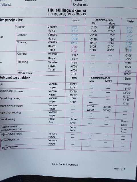

Jupp chainging the lift kit because I needed tuv papers
will switch back to bilstein dampers after approval. They are much better.
that's my opinion
No i didn't need to grind something off the diffhouse at the front
jupp running 22 spline and stock axles front and rear.
The tank isnt scary low , the picture lying a little. dont need it but it is nice to have when I fill the tires after snow or mud driving (fun driving)
tested the locker over night and they went fom 4 to 3,5 bar so no leek.
wheel allignment
the correction arms are 10 degrees more caster and 10 mm longer than the stock one. had caster correction bushes before but the arms are much better
that's my opinion
wheel allignment

Must be a minor difference in diffs or axles then, or maybe the gearing in the pre vvt models makes the main gear smaller and therefore better space to enter the axle. My housig needed a 5mm grind at 2 and 4 o`clock to make room for entering.
I had a 20L tank on a land cruiser once, but it took under 10sec of tire filling before the compressor ran constant. So i didnt bother installing any tank now..
Do you have youre wheel angle numbers available? This is mine, barely over lowest approved value on caster (not castor ofcourse lol).. Curious if youre caster still is within legal spec? I bet its better to drive with more angle, as i feel its a bit sensitive in the center, and does not straighten up by itself good enough for my taste. Expensive upgrade though..
