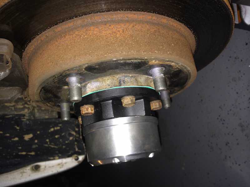

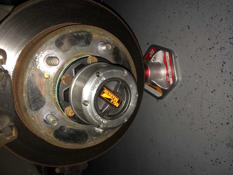

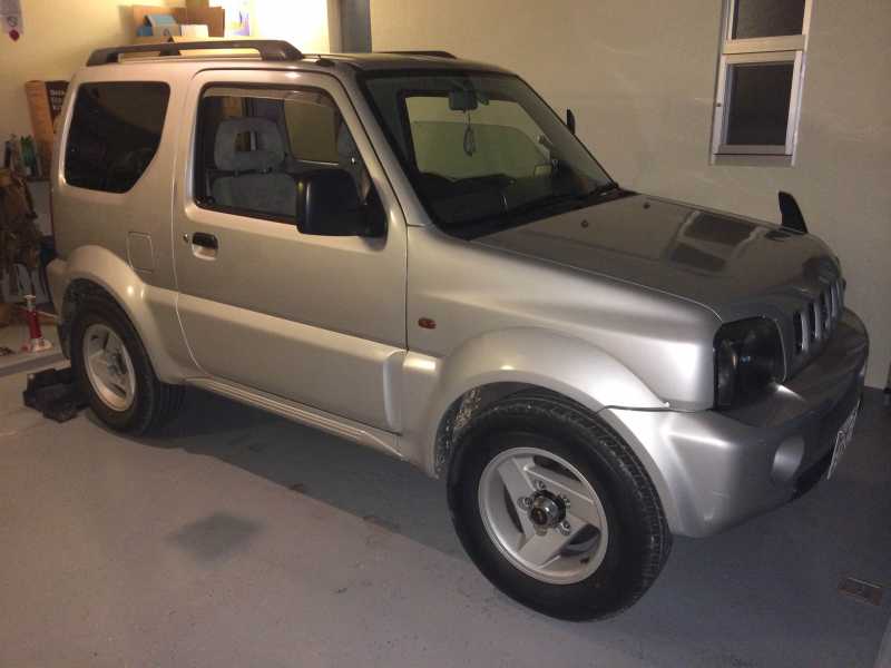

Hello all!
Just finished my first mod on my 2000 Jimny Wide. I put some Mile Marker hubs, which I purchased from Low Range Offroad, onto the little guy. Turns out they fit with no need for any spacer whatsoever, though I did have to use some stock Samurai hub bolts that I had laying around to attach them to the Jimny hubs.. They engage well and bolted right up. I do get the flashing 4x4 light, as it is searching for a vacuum to "lock" the hubs, but it engages and runs just fine. I am very pleased with the look and it seems that there is less drive-train noise while running down the road.
Now I have to figured out what I want to do next...I am still working on fabbing up my custom radius arms. So hopefully, once I receive some key pieces in the mail, I should be able to post some pics of that build.
Well, that's all for now!!!!
Jon
Jon

A nice addition, it looks good. : )

Looks good mate

I think that fitting manual hubs is the single best mod you can do to a Jimny without spending a fortune. They save so much messing about in the long run.

Looking fresh

The hubs look a treat, welcome our fine forum it’s good to have you join us ................
