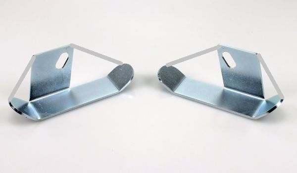

But they still attach with one bolt. So hitting a rock, tree stump or such they'll bent.
Which is why I'm also looking into making a completely new shock mount which mounts to both sides of the shock, like on the front.
Something like this:
Replied by TomDK on topic Dave's (Bits4Vits) Jimny 'laner Build...
Jimny-Dave wrote: I've just ordered a replacement pair from JimnyBits, but Rus has said they should be redesigning them "soon"...
I think they should be folded and welded so that they are shaped like they grey lines added here -
