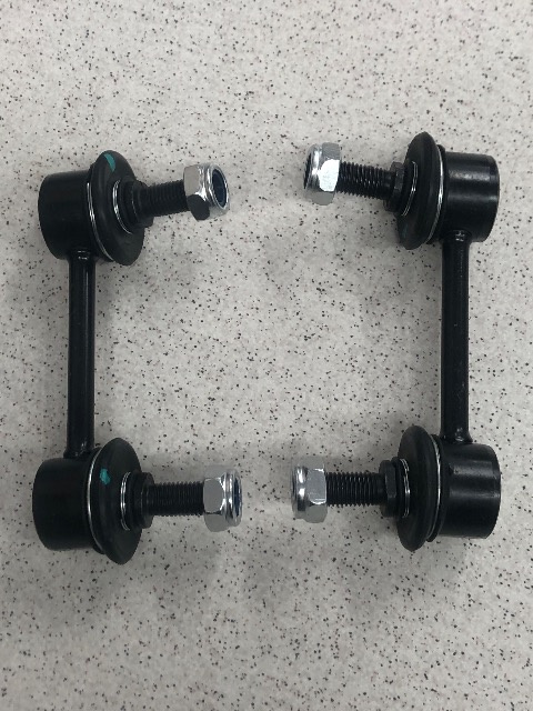

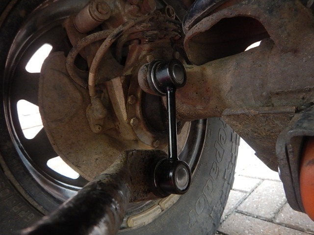

Got a couple of hours off - flu jab this afternoon - so whipped the SuperPro drop links off and sent them back to have a look at them, they are indeed furbared! Nice letter with them explaining that these heavy duy versions have only been on for two and a half years and in conjunction with a JimnyBits antil-roll-bar disconnect system, so that they're not even under the rigorous strain of the monthly greenlaning trip as they are free to move around as the bar is always disconnected for a day's "offroading"...

New standard drop links fitted...

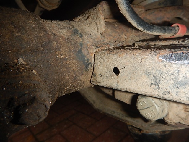

And then onto searching for the crack

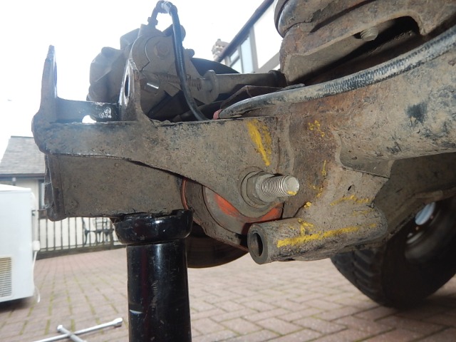

Suspension component attachment bracket / mounting likely to fail Nearside Rear (Panard rod mount fractured)
x
I wasn't sure where he meant? Here? Looks like there's no original weld here?
So I wondered around to the garage and he said he'd marked it with chalk? :dry:
Hmmm...
Lots of yellow chalk lines but I still couldn't see anything?...
So again I wandered around for another consultation...

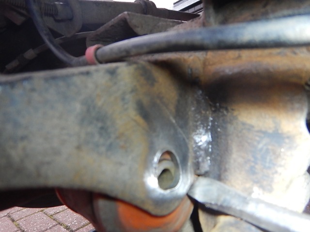

A hairline crack here in the internal corner, god knows how he spotted that, I had to clean the surface before I could even see it!
I'd even jacked it up under the radius arm and under the panhard mount off the chassis looking for cracks!
So I welded it up, and added a welded washer over that oval hole for now...
