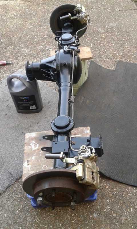

I've done disks - www.bits4vits.co.uk/store/greenlaning-in.../05/11/blog_100.html
Rover Calipers... fluid escaped, and was left with no e-Brake (handbrake, although the yanks refer to it as the emergency brake), so had to crash into low box (with crawler gears!) to slow the vehicle down before it rolled with momentum into a concrete silage silo...
I'll stick with my drums and a cable handbrake ta...! :huh:

Sorry, should explain... on the Rover caliper the cable pushes the piston... but if there's no brake juice, there's no handbrake... :ohmy:
