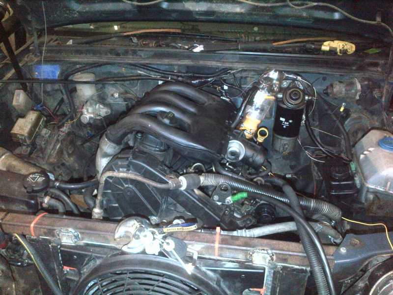

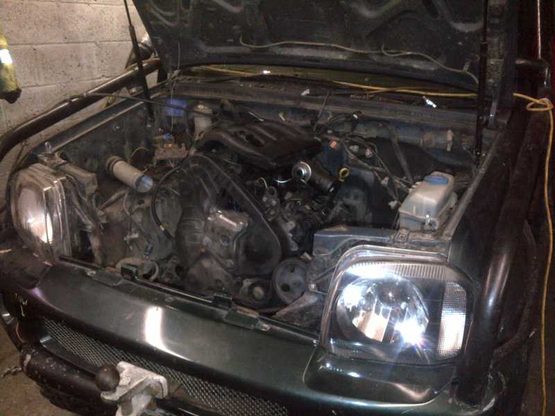

been fitting one of these into my jimny for the last week or so
not been taking pics much just been getting it done lol
pleased to say its defo taking shape now with only a few things left on the list of mods
engine is mounted , wired , plumbed , exhausted
clutch is sorted gearstick sorted
need to sort the rear box mount , propshaft , new fuel line , and a few bit of wiring for ancilliaries
1900 DW8 , pilot box

forgot to measure with the 1600 in it lol , think it dropped 3" ... no engine - engine box fitted so prob
not much of a difference at all

hi mate was watching your post closely but with no new updates i went it alone lol
hydraulic clutch , its taking a bit of getting used to cos of the short travel on the pedal but works fine
the stick came through the tunnel slightly further forward than the original one but this will depend on where you mount your engine of course !
i dare say that if its mounted extremely tight to the bulkhead it would pretty much be in the same place as standard but ive mounted mine forward quite a bit the drawback of this is that the bonnet was hitting the inlet manifold but a trip to the scrapyard and five mins with a cutting disc soon mounted a scoop
the upside is that ive got loads of room around it to work on it and plenty space for a turbo lump when one turns up cheep cheep
