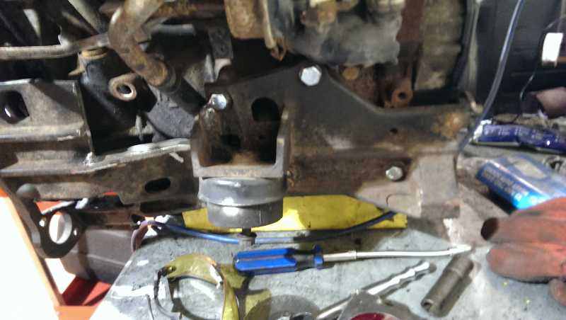

Using a Standard LDV Clutch it bolts straight on.
the LDV Engine Mounting/Gearbox Bracket Requires Modifying to fit around the Turbo Return Pipe and Feed Pipe.

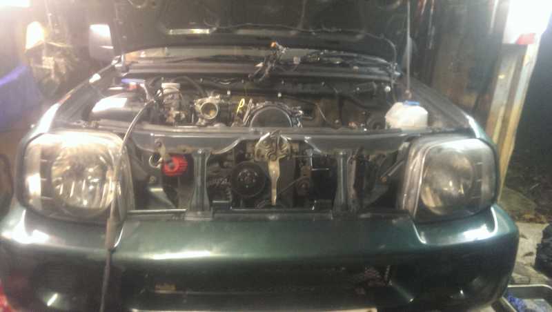

Replied by chris2010 on topic 1.9 td Jimny
PHOTO 3 SHOWS THE LDV ENGINE MOUNTS WHICH DOUBLE UP AS ENGINE ADAPTER FOR PEUGEOT TO LDV GEARBOX.
PHOTO 4 IS THE MODIFIED ENGINE MOUNT TO CLEAR OIL HOSES
