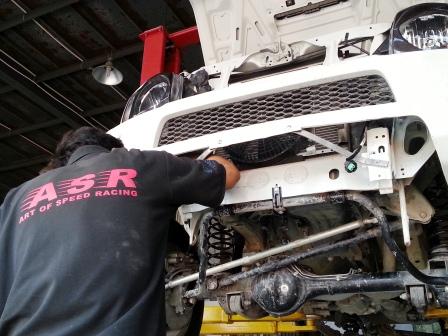

Hey Marky,
Stock is rather large! hehe No problem there!

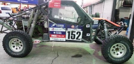

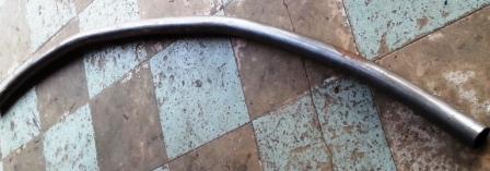

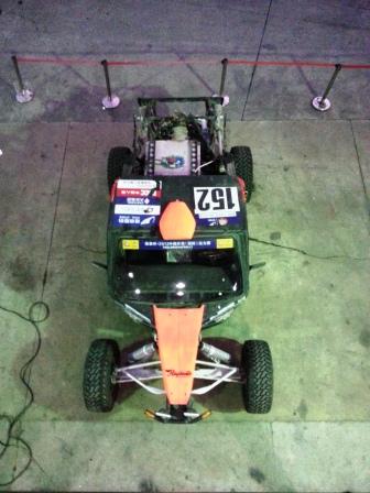

Towing hook? You mean standard point on the chassis? Yes, i agree, was been just for photo! At moment working on the front! Look here. Crome Moly CrMo 45A 50 mm diametar! Super light, super strong! Normally i use this material to build these once:
It is tubular space frame car. trust methat is GOOD material!
So after finished with winch and front reinforcements, will go to the rear. Here is short peak into it.
Considering the road rules in this country, i MUST keep as much as possible STD look and generally speaking the car! So we will fit UNDER the standard bumper all show. Means, upper and lower winch support and chassis reinforcement, front tow points and so on. (NO choice!)
