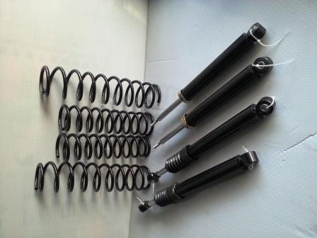

Uh oh ouch... just bought new Jimny few days a go. Give me a lil time please? Just to make shocks and springs for 40mm lift kit did take me 4-5 days! Tomorrow I have ready 80mm and then next week 130mm. So as developing, I will post it. But definetly need a bit of time. heh

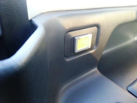

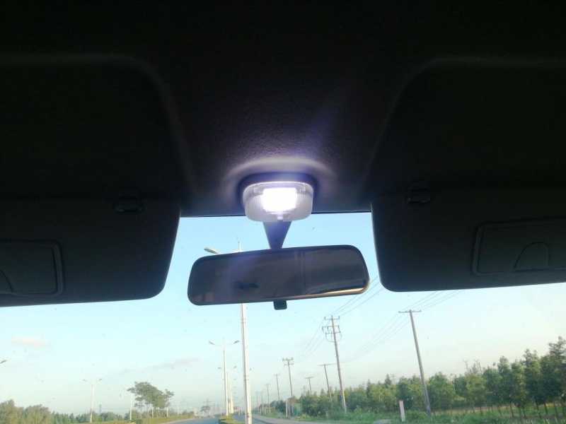

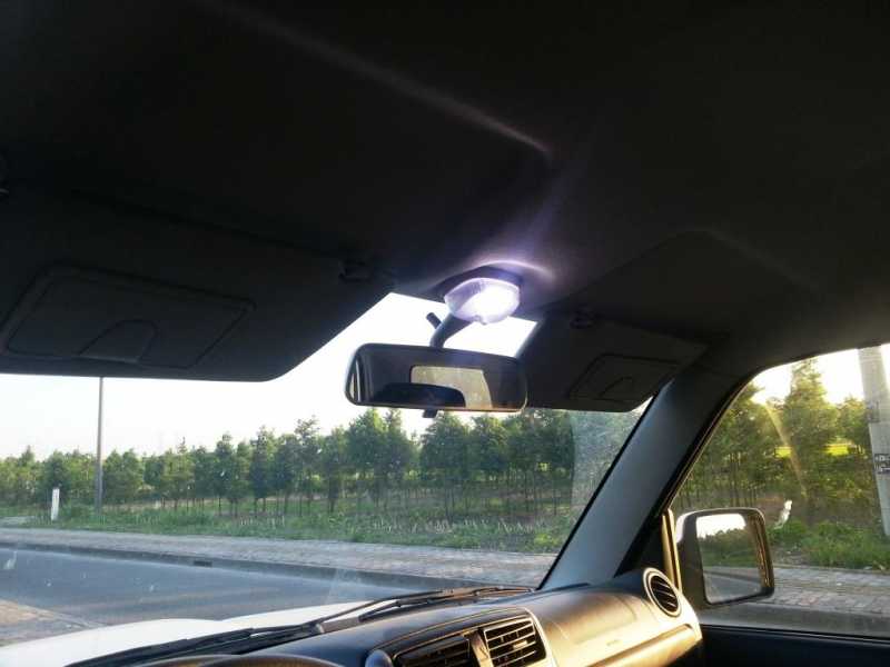

So finally got new lightning! First interior! Next week roof lights!
At moment using 2W super-bright 4X6 LED groups. For test purpose I leave it overnight and all day on for 2 days. Please note that I am still using normal small Jimny original battery. Front one group of 24 and rear 2 groups of 24 LED. No worries at all! Few pics!
Like, really not possible to look into it how bright it is!

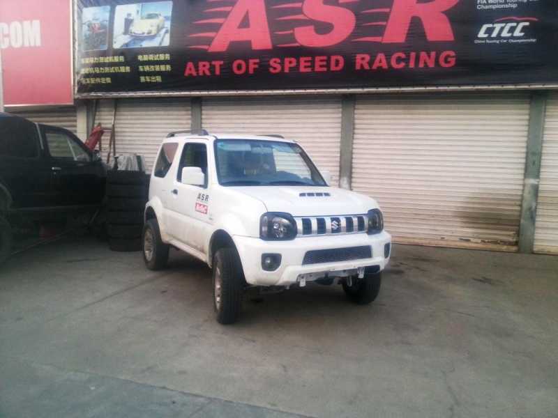

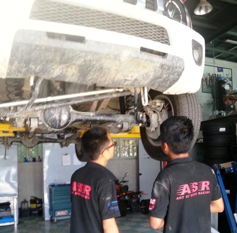

And finallyi did lift my car on the lift for very first time! Joe, one of my crew guys, he did spend few hourse under it to mount our new body lift kit. 50mm body lifted up!
Now I also screw up big time! Still did not even go to put license plate! heh If they dont let me pass must turn first all back and then do check up for first license!

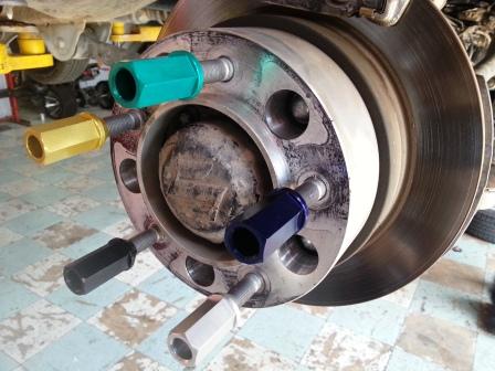

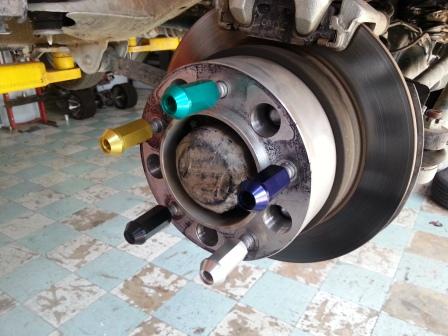

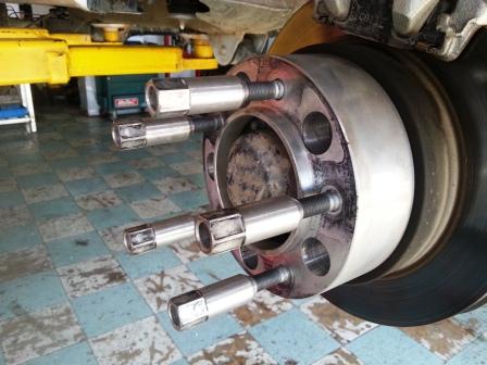

And look at these spacer! 60mm spacer made of AL7075T6! I did use Nissan wheel studs from S15, very high strenght! Also did use Loctite hug locker and press them in 4T pressure.
And wehave cool lug nuts! Made of Al7009T4 or Al7075T6S! Very light, long body for easy finding in the muddy wheels,
and they also come with lug nut cap to prevent that mud, dirt, dust goes on your lug studs and destroy thread. Neat options i think! Available in M12x1.25, M12x1.5 and 4 lenghts!

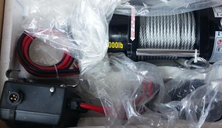

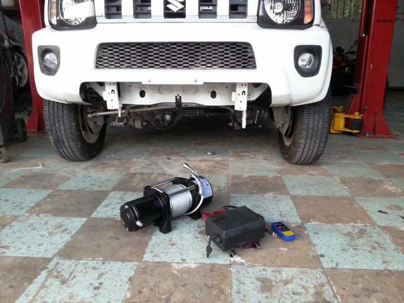

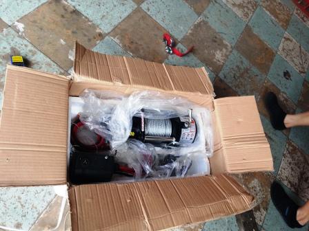

And 80mm kit is now ready for installation! (Brake lines of course too. Its a MUST for anything over 40mm seems like)
Will go this weekend around the city to try to break it! Hopefully some nice movie will be available.
Did also received new winch today! Beauty indeed! With wireless!! heh
:woohoo: :woohoo:
Soooo happy! (Like is my first winch.... heh) Hopefully tomorrow my guys can install it!
