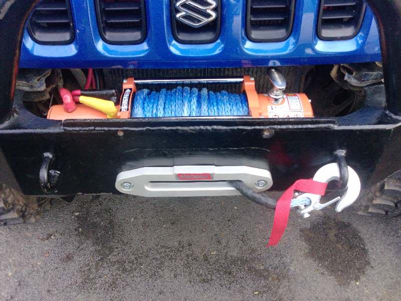

we have a winchmax with a synthetic rope - not the fastest but will pull you out of anywhere - its rated at 13000lbs
