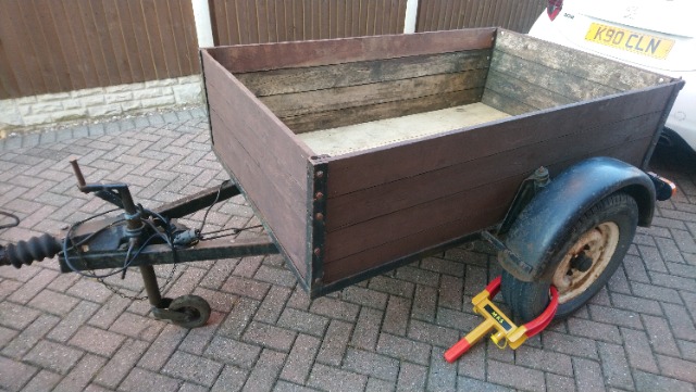

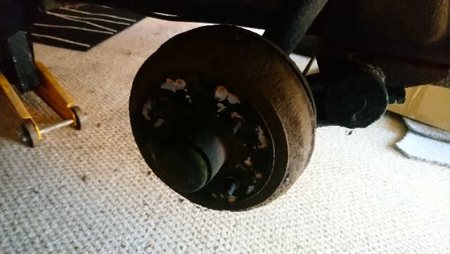

Hi, just bought a project trailer, so need some info / help if poss. Would ideally like to put Jimny wheels on it, but failing that, I need to at least find a spare for what I have.. Currently running 165/13, with 4x112pcd and 70cb. This appears to be an awkward pcd. So, does anyone know if you can get an adapter for this to a more common pcd, or can the hubs be changed? Thanks. (Will update with pics upon completion!)

Quick update - I need glasses, or a better way to measure accurately! Got hold of an old Volvo S40 steel wheel, and that fits (so at least I now have a spare wheel). So hub would seem to be 4x114.3pcd with 67.1cb. Anyone know of an adapter for this to Jimny wheel size? Obviously don't want to spend hundreds. Cheers

I am sure people use a front Jimny stub axle
Welded to the trailer drum
Then use front bearing hub from Jimny

I once had a machinist re drill a pair of trailer drums on a mill for a tractor trailer and that seemed to work. Wasn't used at high speed though.

4x4.5"pcd. Nobody will make an off the shelf adapter because the Jimny uses an equally obscure size, but I question the need to fit Jimny wheels? I know it seems like a sensible idea to have the same wheels on your car as the trailer, but in reality Jimny wheels are far too big and heavy for that size of trailer. A trailer needs its own spare anyway, so you're better off finding one spare to match the others (£50 on ebay), which will fit neatly behind the hitch against the trailer headboard.
