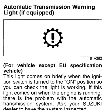

Now fitted by garage and all lights clear except for the Transmission warning light is Amber. Jimny starts drives smoothly in all gears but after approx. 15 mins when warmed up selecting from P to D engine cuts out. Select back to P engine can be started but then select D engine stops. Could be a faulty TCM or ????

In my manuals it states that the Transmission Warning Light is not on European cars?
Therefore this could be a function of the Japanese ECU.
A better measure of the issue would be the fault codes in the ECU or TCU?
