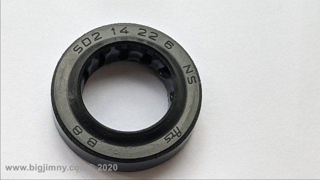

I see yours is 20mm and mine is 22mm (my eyesight failed me)
Anyway I have lodged a technical query on your part number.

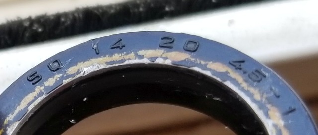

Hi Martin, the one I have has a brass bushing, you cant compress the seal longitudinally.
You can see the brass bushing in mine and I don't see it on the one you posted above.
It has to have the bushing since the selector shaft has no other support.
The number on mine is 50 14 20 4.5 -1 the two middle numbers I guess.
denotes the inner and outer diameter.
After trying a bit with my phone and angling the seal, I got a great shot of whats stamped on the seal.

Replied by mlines on topic Gear shift control shaft rear seal Part # 25517-80F00
Hi
The part is £9.50 and is in the European central stores in Germany, I can get it to me in the UK within a week.
It would then need posting on to you, I think I saw you were in Barbados? Postage will be £6.50 on top so £16 in total
