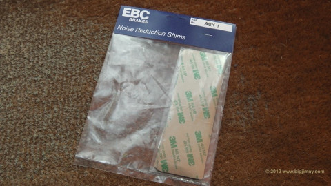

I found these stick on Anti-Squeal pads from EBC on the Internet and thought they were worth a try.

Clean the pads (i used a de-greaser) and mark up the anti squeal pads ready for cutting
Cut out the anti squeal pad and stick it to the back of the brake pad.
