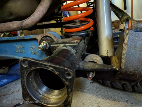

​As you can see from the pictures showing the "orange" springs, I was supposed to be creating a lift based on 3" (or 75mm) components from Trailmaster. However I must have accidentally sold the shocks I had put aside. Therefore for now I have fitted a pair of Rough Country N2 which I still had around from when I sold them.
I had to use some washers to space the shocks centrally between the springs, panhard rods and chassis rail. The bushes were from www.bits4vits,co.uk with the top ones HERE and the bottom ones HERE.
I also used new nuts and bolts from the hardware section of the BigJimny store
