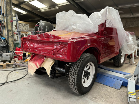

And here she is!!!!
Painting done, now needs rubbing down, polishing and final fit.
The paint being used is a Nexa (ICI) MS direct gloss 2 pack acrylic which is as close to what would have been put on in 1986. The paint code for this SJ is 21L on the VIN plate which is "Suzuki Peruchet Red".
