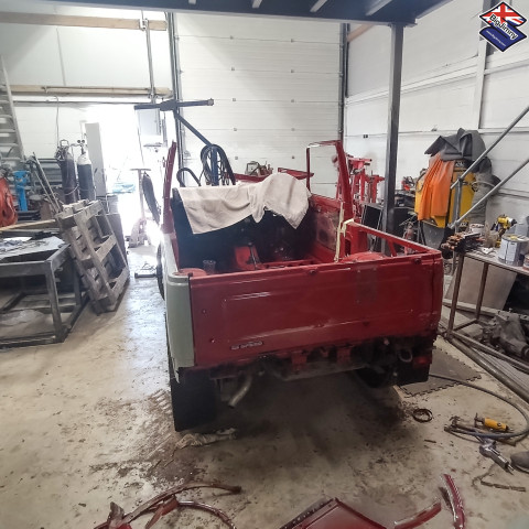

 Here are some wider shots of the SJ. Looks a bit sorry for itself.
The doors, tailgate and front passenger wing are corroded on so they will be tackled in the week to come. They intend to weld nuts onto the screw heads and try and undo them with a socket.
At the rear they trial fitted the rear wing just to confirm that it is correct, looking good!
 If you zoom in on this picture you can see the door hinge screws that have failed to come off :)
