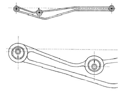

Orientation
Before you start, it is important to understand that some bushes need to be installed in the correct orientation.
Figure 19 - Correct slotted bush orientation
  • The picture shows the correct orientation for standard bushes that have slots in them.
Figure 20 - Castor corrected orientation
    • The picture shows the correct orientation for castor correction bushes.
Figure 21 - Castor corrected installation
