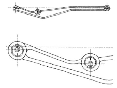

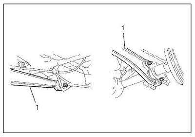

The Leading/Trailing Arms (or Radius Arms) on a Jimny are prone to off-roading or accident damage whilst the bushes are prone to wear.
The arms also control the castor angle of the front axle and the diff angle of the rear axle.
This section covers the changing of the arms, bushes and repair of general damage.

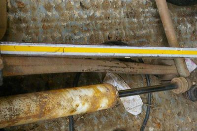

Damaged Arms
- My arms had suffered from a number of years of off-roading.
- They were also fitted with correction bushes, which are good for a 2 inch lift but not really ok for the 3 inch lift I have got fitted.
- The arms on mine were nicely bent when compared to the edge of my yellow spirit level.....
- Therefore I decided to replace the arms and cure the castor correction issues at the same time.

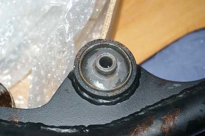

Damaged Bushes
- Worn bushes can be a source of "Death Wobble".

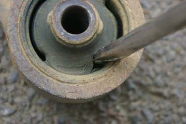

- Here bushes themselves are splitting.
- Whilst they had not completely failed they were not in good health.
- You can see where the screwdriver can open up the split in the picture.

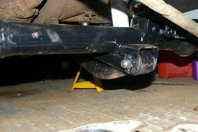

Damaged Mounts

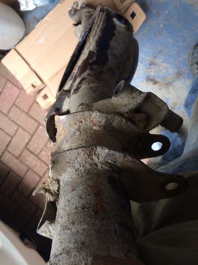

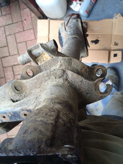

- The mounting points for the arms are really weak and thin.
- They can wear out in an "oval" fashion that results in a strange "clunk" noise when letting the clutch up.
- In the worst case the mount can corrode through and rip away from the axle - this is becoming increasingly common as Jimnys get older.
- Here is a picture from Dave over at Bits4vits showing the wear in his mounts.
- It is worth checking every now and then by undoing the bolts and taking a look at whether wear is occurring.
- For reference, this is what a mount should look like!
- This is the same part as shown in the previous pictures, except it is completely ripped off and gone!
- Again from Dave, his destroyed axle mounting brackets.
- Further information on repairing the mounts can be found in "Axle mount repairs" article.

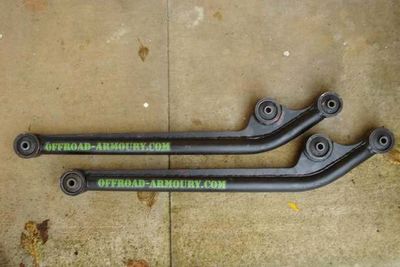

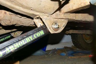

Correction Arms

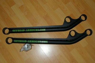

- The picture shows the arms for the front along with a free bush insertion tool with the ones I purchased.
- These arms are made with the adjustment built in.
- Therefore they should be fitted with STANDARD bushes.
- They are typically available for 3 inch or 4 inch lifts.
- Most people feel that 2 inch lifts do not need correction.
- If you are buying aftermarket arms make sure they provide for vacuum piping, handbrake cables and ABS cables.

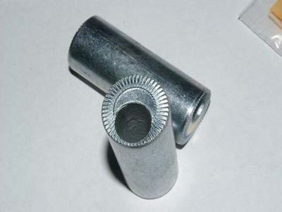

Correction Bushes
- These work by off-setting the centre of the mount to achieve the correction.
- They are popular because of the price.
- However, they are probably best for small lifts (2 inches up to possibly 3 inches at a push).
- The reason is that the off-set required to give a larger lift means there is little to no rubber on one side of the bush, which really affects its performance and ride.

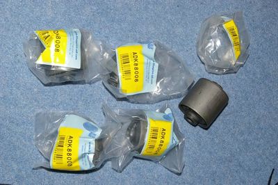

If you want to save some cash, you can also buy these aftermarket bushes:
- ADK 88008 - Front radius arm to front axle (two per arm)
- ADK 88007 - Front radius arm to vehicle chassis (one per arm)
- ADK 88006 - Rear radius arm to rear axle (two per arm)
- ADK 88007 - Rear radius arm to vehicle chassis (one per arm)

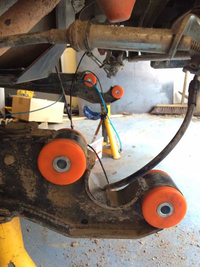

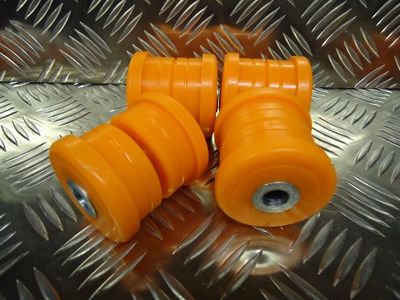

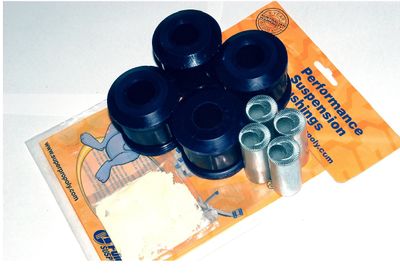

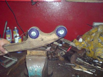

Polyurethane bushes
- A number of after-market suppliers also supply replacement bushes.
- Some aftermarket suppliers also offer polyurethane ("Poly-Bush") style bushes (instead of standard rubber material) and usually come in the form of a split bush which can be more easily inserted in the arms.
- For example here are some from Dave at Bits4Vits

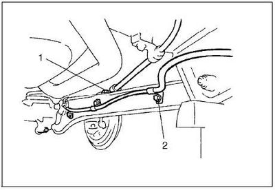

- Those of you with older Jimnys may have the vacuum tubes for the locking hubs routed down the arms.
- If you are putting new aftermarket arms, make sure that they have made provision for the vacuum tubes (front) or handbrake cables/ABS cables (rear).
- A lot of cheaper replacement arms forget these fundamental items.

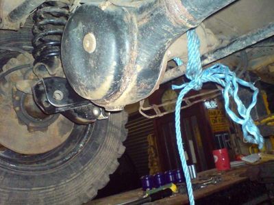

- As the axle will be hanging free, make sure it is secured in position to stop it moving too far.
- Otherwise bolting in back up may give issues.

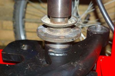

- The first is to press them out with a hydraulic press.
- This is the method I went for.
- I went to the local garage and they pushed them out for beer money.
- However people started to leave the workshop when gauge on the press went through 35 tonnes!.
- They finally moved out at 38 tonnes with an extremely loud bang.

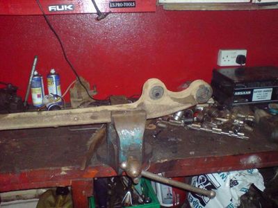

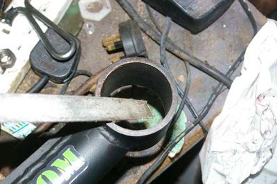

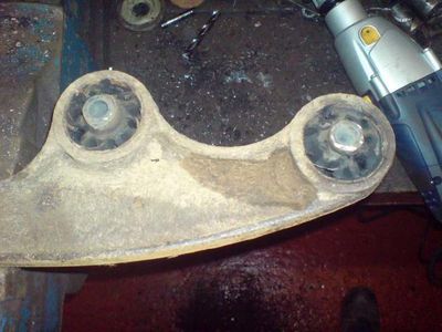

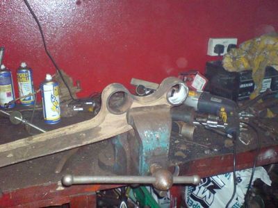

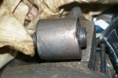

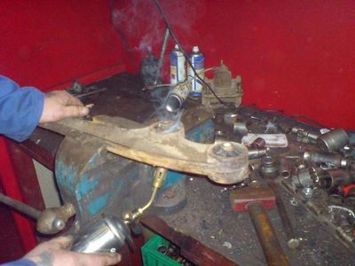

- Another way to remove them is to cut out the centre rubber section and then carefully saw two thin cuts in the remaining steel sleeve.
- This is the method Brian from the forum used and sent in these pictures.
- With the arms secured in a vice, you can drill out a lot of the rubber.
- Then you can burn the rest of the rubber out.
- Finally cut the steel ring that is stuck in the arm with a hacksaw and chisel out the remains.

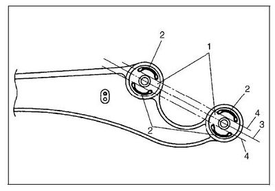

Orientation
Before you start, it is important to understand that some bushes need to be installed in the correct orientation.
- The picture shows the correct orientation for standard bushes that have slots in them.
- The picture shows the correct orientation for castor correction bushes.

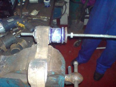

Polybush installation

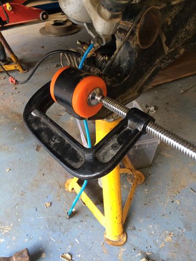

Polybush style bushes are pretty straight forward to install.

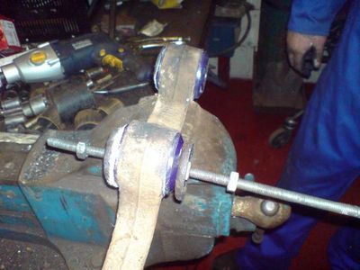

- First grease the inside of the arms.
- Then you can create a puller using a long piece of studding and some large washers.
- By tightening the nuts the action pulls in the bush.
- Studding is available from builders merchants.
- It is then a straight forward task to fit the bushes.
- Apparently it is then easy to push it all in the final bit by hand.
- If necessary, I understand other people have used a Rubber Mallet as well.

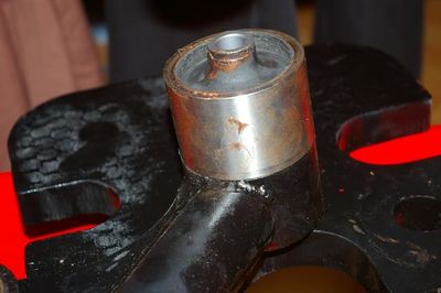

Steel Cased bush installation

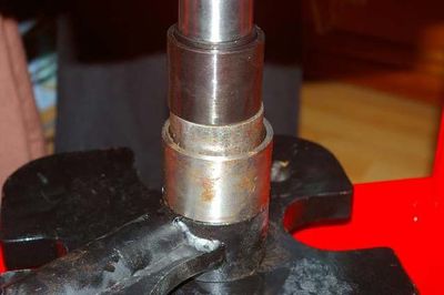

As previously stated, the steel cased bushes need to be pressed in. You should be able to find a local garage or engineering shop prepared to press them in for a small consideration. However, as I have worn a bit thin my welcome at my local garages with pressing in wheel bearings I decided to splash out on my own press. I am glad I did because of the time it took to press in the six bushes would have definitely seem me less than welcome at the garage.
- The picture shows the principle behind pressing in the bush.
- My arms came with a press tool.
- The outer ring from the tool is placed over the hole and the bush is dropped in (with a smear of copper grease to help everything along).
- Then the centre part of the tool is placed on top of the bush and the pressure is applied using the press, driving the bush into the arm.
- Result is a bush neatly pressed into the arm.
