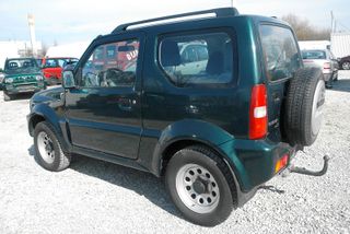

Tow hitch
  • This is a typical tow hitch sold in the UK.
  • The tow ball should not be left in place in normal driving as it obscures the number plate.

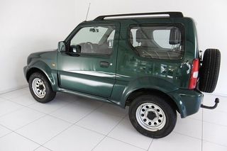

Some pictures of Jimnys 3 with very long tow balls (all from continental Europe):
Suzuki Jimny 3 with EURO style tow bar

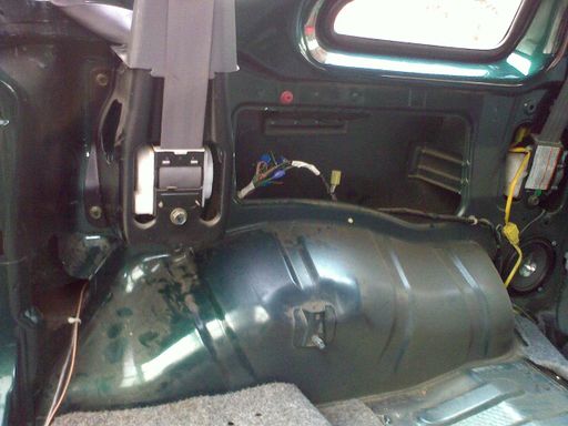

Access procedure:
  1. Remove the rear left seat;
  2. Remove the lower rear left plastic trim (between the rear left window and rear left wheel arch);
  3. This will reveal the wiring harnesses that go to the rear lamps;

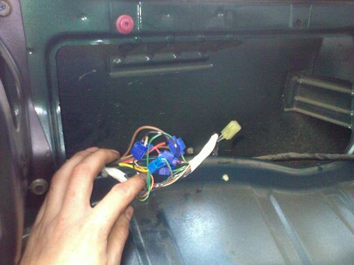

One of the pictures below shows the wire splicing method by using "scotch locks".
Using "scotch locks" (or any other non-soldered wire connection) is generally considered an unsafe / "el-cheapo" connection method, which has a long term risk of producing electrical glitches or even catching fire!
