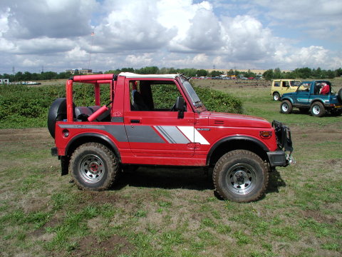

When you say "tin roll hoop" do you mean the "Targa bar" that is part of the actual construction of the SJ or the optional Suzuki Roll Hoop?
If you are going for authenticity then the optional suzuki hoop would be your only choice. As James is doing a "factory" restoration he has gone for the Suzuki hoop of course. However the hoop is not particularly strong and back in the day was not compliant with AWDC regs for a lot of their competitions. The rear brackets on it are for "support" and not strength.
If you need to have it as a real functioning roll bar, I would go for a look-a-alike standard hoop but made of certified tube and with proper rear angle bars down to the back of the car and big spreader plates to spread the load and bolted through to the body stiffening members underneath
I have attached pictures of the Suzuki roll hoop
Sent from my moto g42 using Tapatalk
