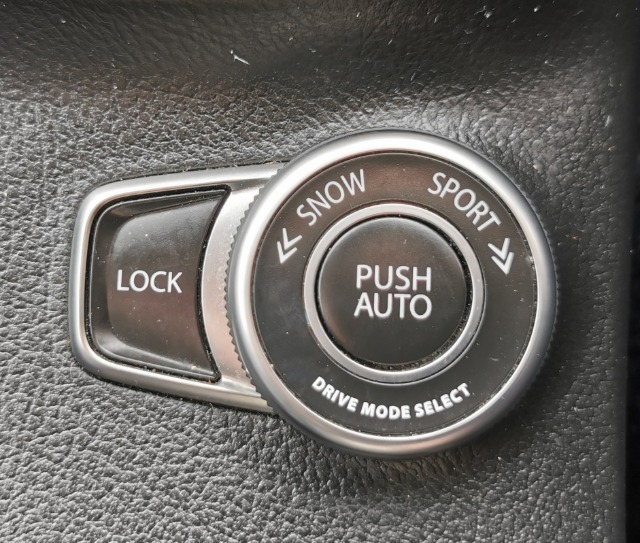

Hi guys,
I've just bought a 2017 S-Cross AllGrip as a family car. I still have my 2004 Jimny, and I had a 5-door petrol Grand Vitara for a year, so this is my third Suzuki 4WD system.
I understand basically how it works - auto, snow/mud, sport and lock all seem to essentially automatically engage the rear wheels as traction is lost, but with varying degrees of eagerness. I had thought 'lock' mode would equally split the power between the front and rear, but it seems there is still a degree of slip.
I have really struggled to find detailed technical information on how the system works, and would really appreciate any information that you have!
Many thanks

Replied by facade on topic AllGrip Select (S-Cross/Vitara)
I'm fairly sure it is the Renault system that they use in the Duster, Qasquai xtrail etc. It is similar to the haldex used in VW, Audi etc.
There is an oil filled multiplate clutch in the propshaft (like a motorbike) and an electromagnet rotates a cam that forces the plates together. (In a haldex, the plates are forced together hydraulically, there is a pump and accumulator attached)
The Plan is- when in auto, there is no drive to the back, and when the front wheels start going faster than the backs it tickles that clutch until it gets the back wheels to catch up to the front.
It can go from zero (apart from fluid drag) to 100% lock in theory, the com-pu-tah controls the clutch, and the knob on the dashboard alters the parameters, like how quickly it attacks and releases and how much speed difference it permits. (I've no idea how it knows when to release, probably it just slacks off and winds on until either the fronts go say 5% faster than the back or it gets to free)
If you put new tyres on the back, and worn ones on the front it will overheat the clutches as it continually tries to make the back wheels go as fast as the fronts.
EDIT : www.awdwiki.com/en/suzuki/
Looks like I was fairly right, apart from the mode knob also brings the brake draggers into play to control wheelspin, like a poor mans difflock on each axle.
