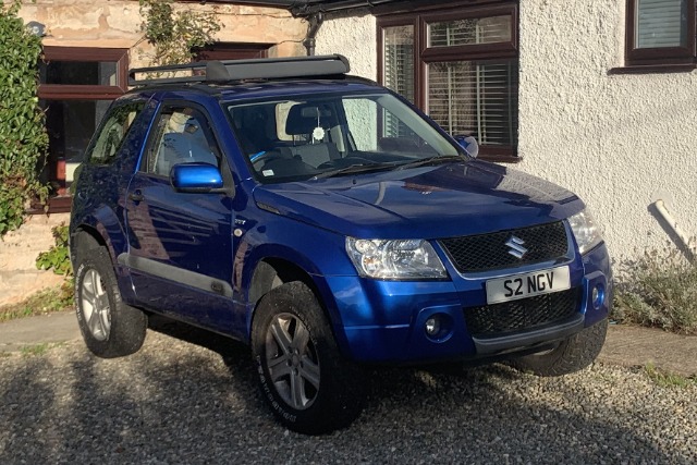

So here it is parked outside my little cottage -
I washed it yesterday... and looking at it I felt the front suspension had sagged a little since it's 2" lift kit was fitted? The back looks fine, but there's quite a rake to it?
So, lots of time on my hands I started googling new lift kits, as you do. and then saw the price!
Put the kettle on, had a cuppa, and my mind started ticking over.. it can't be the front strut spacers? It must be the old tired springs and struts themselves? So I looked at car part websites for fresh items, and then my brain ticked again.. instead of putting my own personal registration number in, I jumped on eBay and found an advert for a 1.9 DDiS model, and used that registration... indeed the aftermarket springs are different part numbers for the heavier engine! So I ordered new struts and springs for £150.and will get my mate at the local garage around the corner to fit them, as he has the special machine needed to fit the springs onto the struts... Result!
The rear springs and shocks are already new replacement lift units, so a complete refresh on the tired suspension then I'll let you know how it turns out

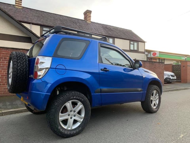

(If you look a few posts back, you can see the rake of it)
