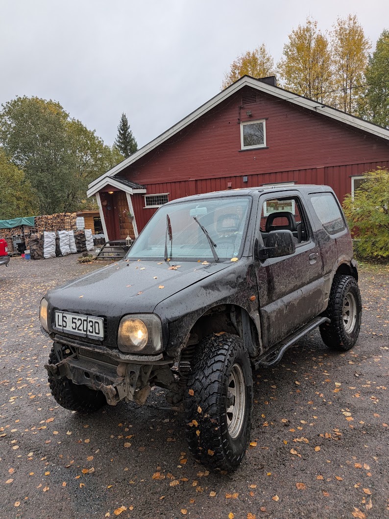

Suzie lost som body panels in the garage last saturday, but also gained a set of bigger tires. The body mounts have to be adjustes, i guess that is what sledgehammers are made for?
But now the small truck is getting dangerously high even in 1st low. I have to do something about the transfer.
My main plan is Suzuki 413 transfer, with superlow gearing kit. I guess 4,9 is suitable, but some advise will be appretiated.
I.E i would like to know about quality differences between different gear manufacturers...

Got my hands on a SJ Transfer today, so have to concider ordering the gear-kit and a mounting cradle so it can fit into the SJ.
Also working on making space for my larger wheels, and even with battery disconnected i managed to set off BOTH airbags. Scared the living daylights out of me, thought the car was falling from the lift...
Nevertheless, i managed to remove som Suzuki, and even that rust, water, body sealant and water was a hard mix to weld, i now can turn quite large tires. Goal is 35 inch..
