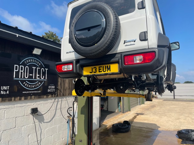

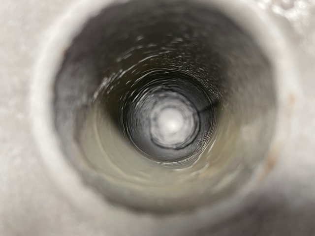

Looks great, where did you go to get that done?
Also where did you get the chassis Bungs?
