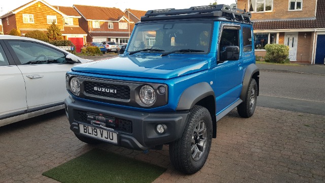

Jimny-Phil wrote: Hi Guys (and Gals?)Been lurking on this forum for some time, reading all of your very informative posts.I purchased my brand new 2020 Jimny in February and thought that it was about time that I reciprocated and posted something for anyone else interested to readSo, to start the thread off, here are a few pics of my Jimny a week or two after I collected it in February
PJ

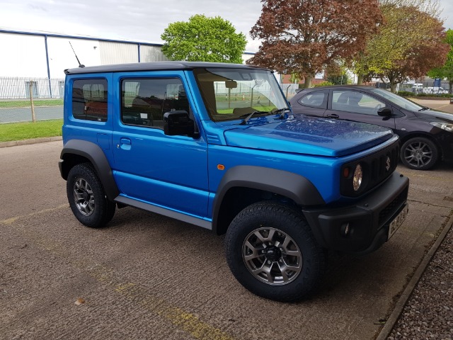

I just written a huge thread, and then pressed delete by mistake, so here i go again.Hi PJ, welcome to the forum. Ive been following your thread and it brings back fond memories. I began just like you, perhaps you read some of my posts. Anyway i wanted to say hi, and wish you all the best on your jimby journey.Beware it can become addictive and if your anything like me and others, your love and obsession for your new 4x4 will grow. Ive never stopoed lovin minr.Thought you might like to see my own progression. And im here if you have any questions, we all are. Cheers. New tyres arrived before my car, AT toyo open country AT plus. Great tyres. Will never 4get collection day, so exciting. New tyres fitted.

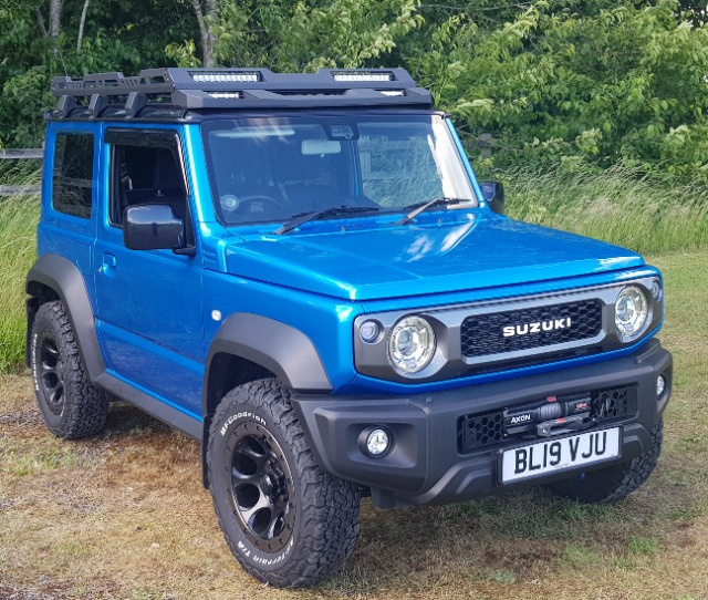

New grille day. Fitted lots of mods and accessories. But a tip, although its tempting to buy all and sundry for your new toy, keep an eye on the weight your adding. Ive reached my limt now, so just a little tip, keep the weight as low as possible to keep the best 4x4 the best 4x4 lol.
A roof rack added.
Winch added fairly recently. Told you its addictive

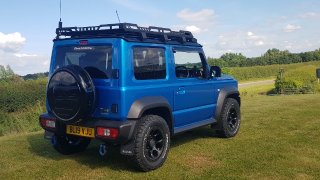

Ive installed a whole host of undebody protection. Fuel filter, diffs fron rear, radial arms, shock mounts and transfer box. Tbh...i think diff gaurds are over kill and i may remove them soon.
Taken today.
Last month
And here she is today. The list of mods has been endless. Like you i began scouring this site for ideas and advice. 2 people more than anyone gave me inspiration and guidance, i wont embaress them, soeley and gadget!
