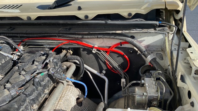

Fitted some extended diff breathers. Using a kit from Vitmods and routed the breathers into the engine bay:

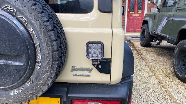

I had to modify the bracket to get the hing cover to fit. Not a major mod, no idea why it doesn't come so that the cover fits back on. I sadly trimmed a little too much of the cover, when getting it to clear. Mostly because I hadn't at first realised the bracket blocked off the mounting holes for the cover. I'll try and get another cover in due course and do a tidier job, plus get it all wired in.

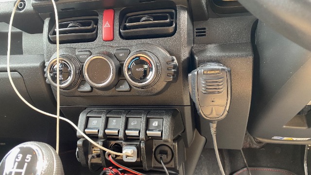

eventually decided on a location for the CB mic:

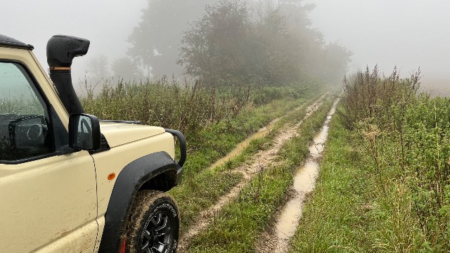

A bit foggy and muddy on day 1. But pleased so far with how the Jimny is coping. Also got a record high mpg on the way down.

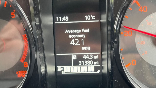

Day 2 Salisbury Plain.
Had a great day today. Went and filled up, well topped off the tank. Then hit the lanes. Was out all day and showing an average mpg of 17.1!
The Jimny has excelled at laning today. Comfortable and capable. Lack of under the diff clearance has showed itself once or twice. But mostly fine. But did get stuck in some ruts that the Land Rovers in the group breezed through.
Some taller tyres might be in order at some point.

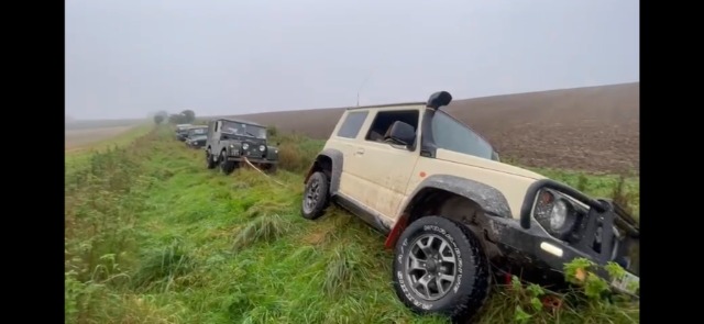

Day 3, the final day in Salisbury Plain.
Didn't do as many lanes today, but still got a few in.
Sadly I did get stuck again, although, like yesterday I was leading. I attempted to straddle a deep rut, but the bank was higher than it looked and as the drivers side went up, it pulled the passenger wheels into a rut and sat me on the diffs/chassis and anti-roll bar links. Had I been in my Land Rover, I'd have just driven in the ruts.
It all got a bit leany and took a few recovery attempts to get out, plus a big of digging with a shovel from my brother.
Had I not got stuck here, I would have 50 yards up the lane. The ruts got deep and there wouldn't have been room for anyone to have gotten past. And no room to turn around. As it was, my brother lead in his Ninety and we had the rope on and all got to the other end with no more dramas, but it was sliding on the diffs quite a lot and certainly needed a bit of assistance.
That said, I'm still hugely impressed with how the Jimny has gone. I'm also impressed with the tyres, despite the fronts being quite worn, I haven't once felt lacking for tyres grip (just clearance). And I've been able to drive in and out of most of the ruts to pick a line. I really wanted to get Mud Terrains next time round. But in reality All Terrains make more sense as it is my daily driver. And with how the Wormdrives have performed, I think I'll probably go for another set.
