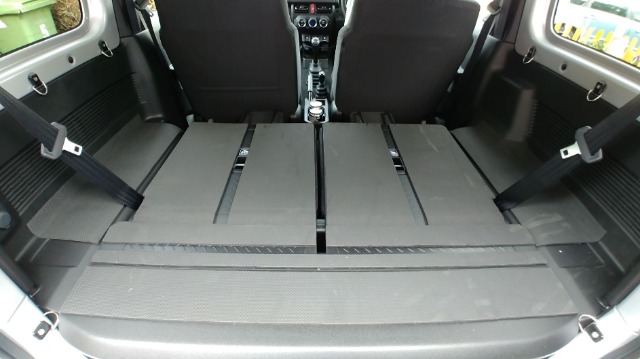

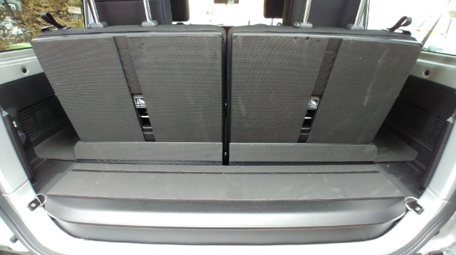

Less than a week after picking the car up I was off to Porto via Gatwick. I’d had a few bags of shopping sliding up and down behind the rear seats and the thought of suitcases doing the same prompted some quick, if only short-term mods.
Some anti-slip covering for the rear £22.95: - www.amazon.co.uk/gp/product/B071HFTRCH/r...09_s00?ie=UTF8&psc=1
This stuff works a treat, the cases didn’t move and now the shopping in the stays put.

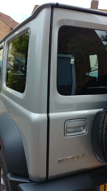

Some Door edge protection enough to cover all three door edges £10.99: - www.amazon.co.uk/gp/product/B07DKYGY2J/r...07_s00?ie=UTF8&psc=1
Does what it should and looks ok with the Silver/Black.

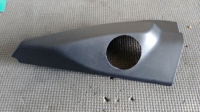

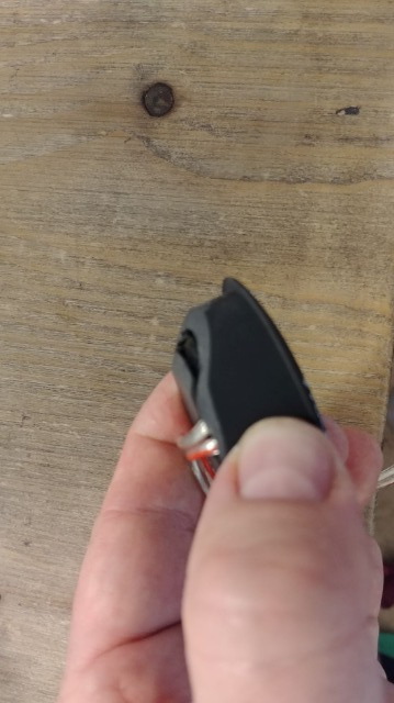

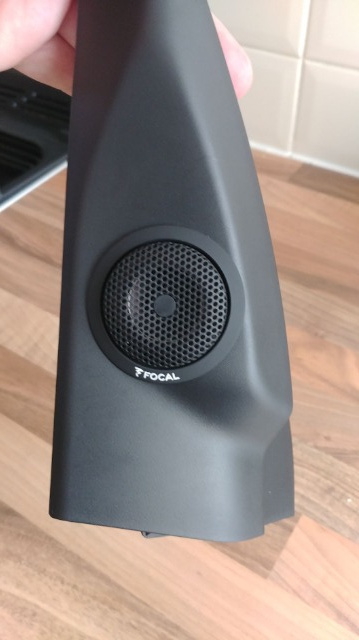

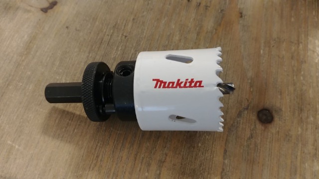

The Tweeters really are too big, but I made up a foam disc and figured they might just with some effort. I accurately marked both plastics with some dividers and then made the hole in the first one.
I just held the hole saw and used my hand to turn it, after making a pilot hole.
The cutter was new and made a good hole without power tools, as I didn’t want a slip or snatch.

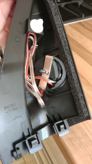

While offering up the trim, with the tweeter housing fitted, to the door frame it was a long way from clipping back into place. The Tweeter panel mount had room to spare behind and beside the tweeter, which fitted with a bayonet locking twist. I therefore go to work with some course grit sandpaper.
After much trial and error and with nothing left to sand the panel clipped home. Phew!

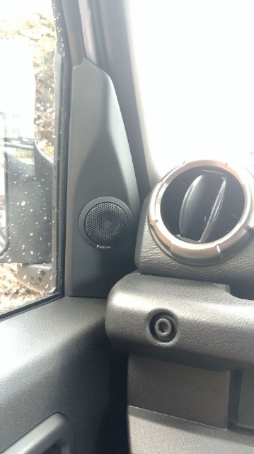

I’m really pleased with the external finish, and although it looks beaten up, the tweeter housing is still very solid.
Rise and repeat for the other side now I know the hole measurement was optimal.

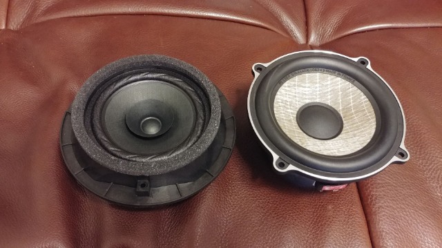

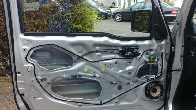

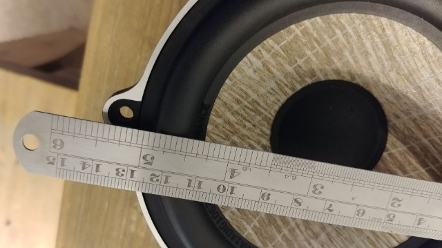

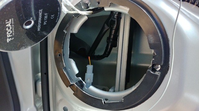

Next onto the woofers. I bought the 13cm upgrade kit from the Big Jimny store, however it seems to be too small for my 13cm/5 ¼” speakers.
I suppose you need the smaller speakers with two sets of holes, looking at Gadgets guide with hindsight. I would argue that maybe the pioneers ain’t 13cm but seem to be a dual fit. Anyhoo I’m no expert and I’m gonna make mine fit regardless as the adaptor spacing depth seems key here.

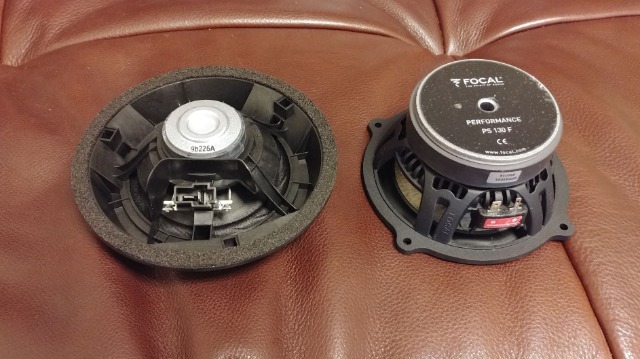

A quick speaker old/new comparison

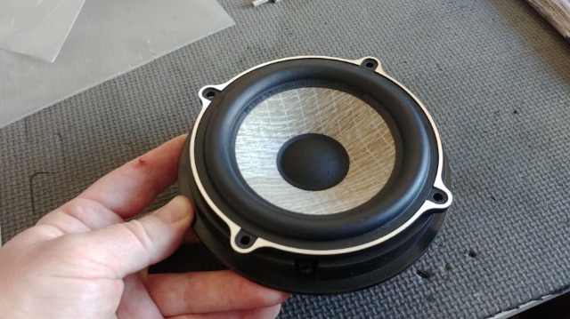

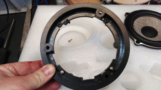

My speakers have a 5 spoke basket, which means getting the adapters in the vice and filing. It doesn’t need to be pretty (erm, cos it’s not), it just needs the basket to fit.
There is still enough material in the adapter that I can drill four small pilot holes and fix the speakers with the self-tappers provided.

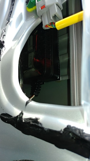

I needed to perform one more horror with my sheet metal nibbling tool, in order to make the speaker terminal post fit into the door skin.
The crossover was stuck in place using some 3M dual lock and loop Velcro type stuff, in case I need to retrieve it at some point. The Crossover set switch was at -3db due to the tweeter location.

Great stuff, love the tweeters - you're braver than me chopping holes in the trim!
02 Oct 2019 19:04 #214202
Replied by Soeley on topic MrChips Silver SZ5
Tweeters look factory fit, job ell done.
