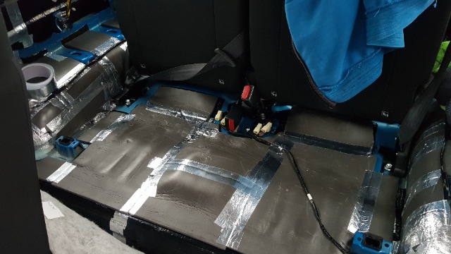

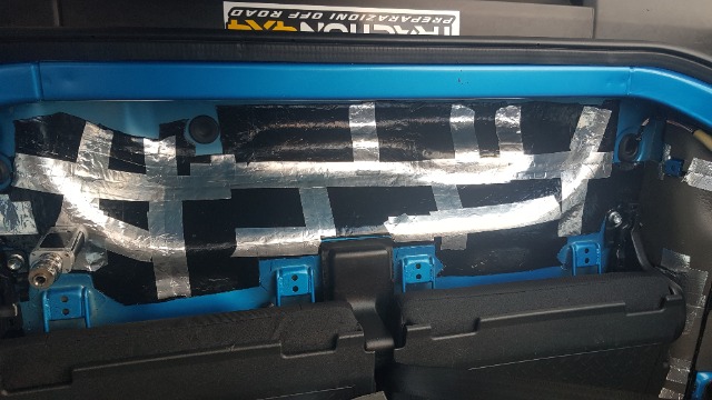

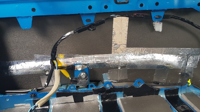

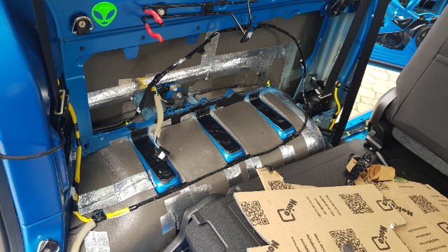

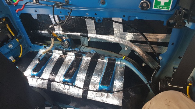

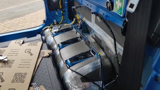

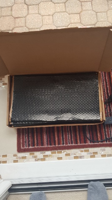

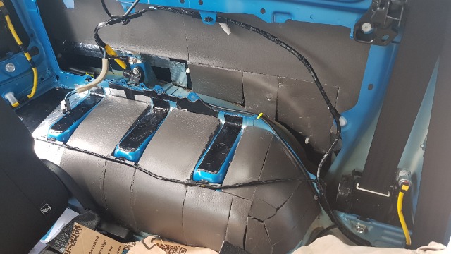

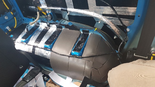

Embarked on a sound reduction project. Sound proofing is just inacurate.
Bought some Noico sound mat for stage 1.
This stuff is not made in china, but rather Russia.
So getting this stuff down is fun in my book, and ive really enjoyed it thus far
So I behan with the rear wheel arch. The project goes in 3 stages. 1 is the dampner, for panel resonance and making the sides sound like a safe door when ye knock on em. In the wet, this has made a huge difference. And stone flicks can barely be heard.
I overlaped the edges with sealing foil. No moisture can get under the stage 1, but just to seal and doubly make sure i taped it off.
Next was the closed cell foam for stage 2. Seal from moisture and condensation build up, also to create a touch of in car sound softening for the stereo and finaly to create a de coupling for the stage 3 MLV layer.
Foam being added
And more with tape.
Also the same with rear quarter panels
Next was the rear jack caryying area.
And under the rear seats.
Stuff been used is as follows:
Noico stage 1 panels 2mm
Noico stage 2 8mm closed cell foam
Sealing thermal tape
Stage 3 MLV Mass loaded vinyl
Next job is to stage 1 the front of the jimmers, doors, floor, rear door, firewall and roof.
Expectations are key here, many folks believe they will silence their ride, and that would kill the spirit of the jimny for me. Instead i wish to just quiten down the road noise a touch, and create a nicer place to be, with good sound from my stereo and less engine roar.
More to come as the project continues. Took me 2 days thus far :laugh: :laugh:
