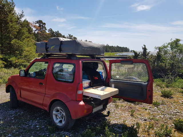

This is the little donkey. Has a few marks on it, and is a bit of a work in progress.

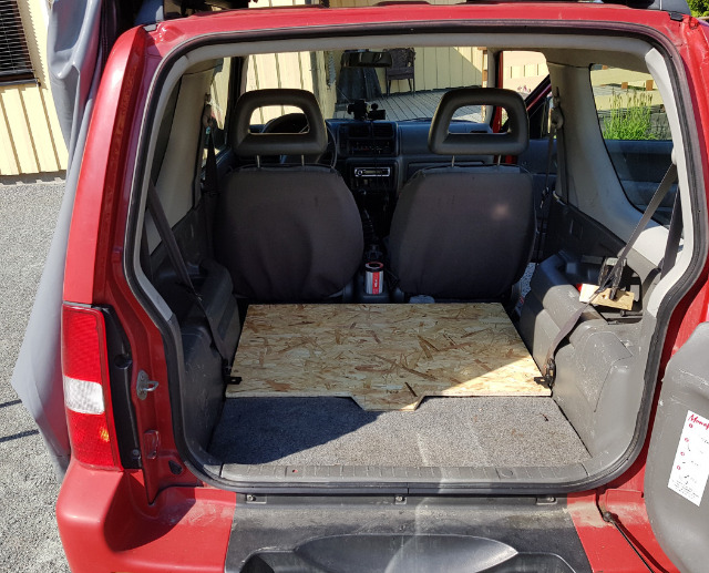

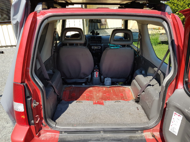

I started with tearing out the back seats.

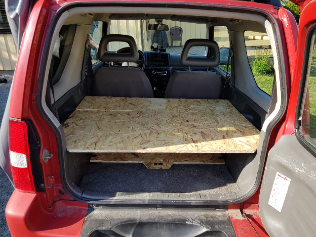

Added base board
Cut and shaped top boards
Then applied a bit of magic, and a gap of time. (I simply forgot to take pictures)

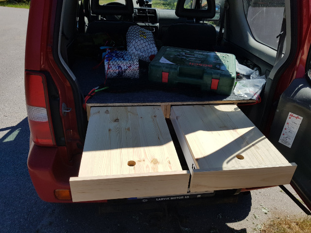

Drawers with working surface.
If you look closely at the 2nd picture, you'll see that the top surface is actually two parts. The part that is towards the seat is the lid for two compartments, while the main surface is covering the drawers. The surfaces are supported by solid walls, in both axis. One following the line where the two surfaces meet, and the other goes along, and between the drawers. The walls stiffen the construction, and carries a lot of the load.

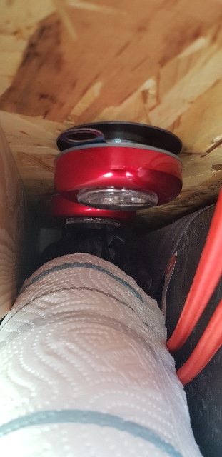

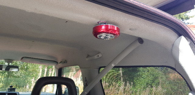

I made some small lamps, that I can stick to the ceiling (or anywhere else where there is metal), so I can have a nightlight.
I got two of these, and they are stored on the right side, of the right drawer. They have a thin magnet strip they can hang onto there, while not in use.
Here they are.
Easy to grab, light in the back if I need while cooking etc, or read maps, or whatever.

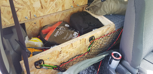

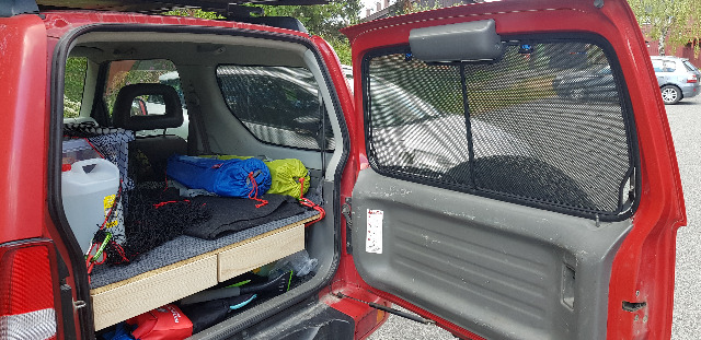

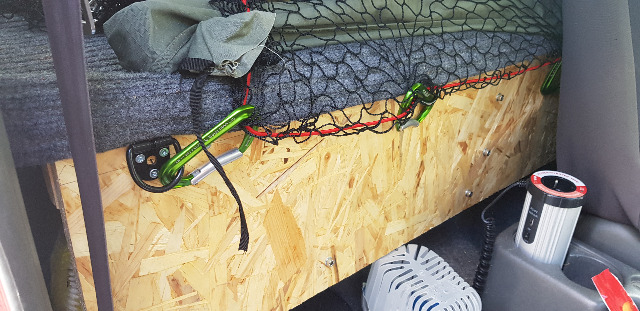

Then there are the two compartments towards the seats.
As seen, there are fasteners there for the cargo net. These two compartments are intended to store things I don't need normally, like tools. One compartment is for tools and such things. As of now I have one free compartment, that I might turn into a water container.

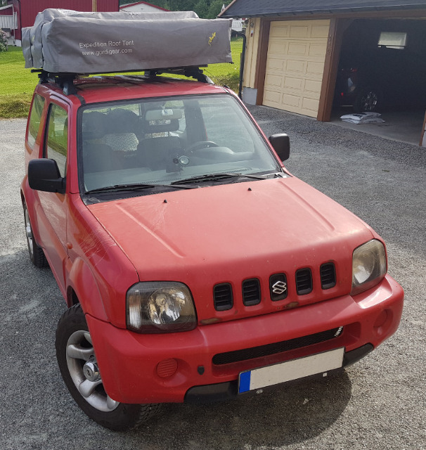

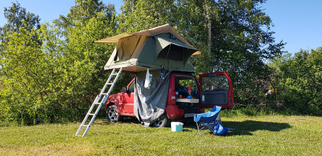

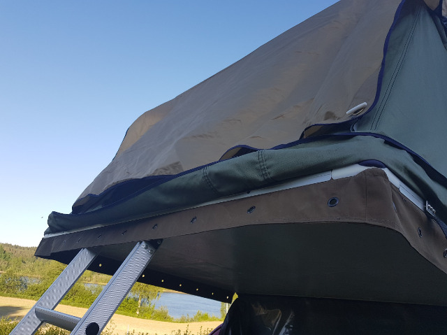

As seen on the first picture, I got a GordiGear RTT. I don't have the "bottom tent" to attach to the underside, so I utilized the attachment "tube" on the underside for a home made attachment.
Basically a skirt with strengthened holes. I've gotten to use it for a lot more than I had ever planned.
Quick lunch this summer.
And full camp

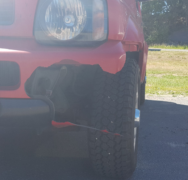

And here is the result of car vs deer. It's getting fixed, finally. All parts are ready this week!
Added base board

Is the roof tent mounted to the standard roof rails or custom brackets?
- TaterTot
21 Aug 2018 09:51 #195322
by TaterTot
Replied by TaterTot on topic My RTT Jimny
Yes, it's all just standard. The tent-side rails are just a tad wide for the the particular roof rails I have. We are talking mm here. The "feet" for the rails, that attach to the roof rails, are angled a bit inwards. So to make it fit well, without damaging the "feet", I had to in-lay a few steel plates between the rail bar, and the bottom of the tent bracket.
That said, I plan to ad another set of rails, so I get 4 bars, not 2. One reason is to spread the weight, and help stiffen up the tent floor. Another is that I want to use 2 of the bars for a small table outside the head end of the tent.
This view, with a cup of brew right outside the tent, on a small table, would be a pretty sweet morning.
And I have the table surface in the car already, just use one of those drawer boards.
